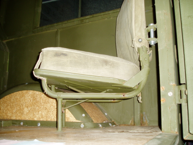

Dear Mr.Clark!
today I´ve been to my friend - he said - "say him to come here to visit us, we´ll go for him to Prag to the airport and will take him here, we can have a chat abaut our darlings or say him to take his C8A here and we will restore him it " so that´s no problem... I made a lot of photos (seats and the space behind rear wheel), can I send you all of them? I´m looking forward to your photos!

Much gratitude for the jump seat pics - now I know how the things are supposed to look and how they work.
I like the taillight setup also.

Not very often we get good clear pictures of the inside of a HUP......
Strange to see that particle wood in the rear fender..... yours are all steel Rob....... also check out the stange checker plate pattern from the rear underside shot.....
Wonder what the front springer hangers are like...????
Rob ........I guess we will be modifying some CMP seats to fit your HUP.... hahaha.

Rob, The checker pattern is on the underside as the PERS-3 staff car had a linoleum floor, so the plates were just flipped and flopped to leave the smooth side up. Mine's the same.
Really neat to see the toolbox setup under the rear - that will be a whole project in itself.
The front spring hangers are waaay different from the earlier HUPs, as they are at the front end of the frame rail and back up a big casting on the inside which is the bumper mount - something else I'm hoping for pics of from Frantisek (hint, hint).
As for "wood" in the rear fender - are you referring to the fender welt? Or am I missing something else?

P.S.-what wood are you talking abaut?
Bob,
Are you looking at the item that is sandwiched between the frame and the body just behind the eye bolt (frame hold down bolt)? If so, it is either one of three items:
a nice piece of hardwood that fits in the frame rail and acts as a guide for the other eye bolt on the other side of that frame rail, or
a larger and flat piece of hardwood that runs along the sides of the chain locker, or
a smaller piece that acts as a buffers and guide for the long rods that hold the locker to the underside of the frame.
Another nice touch with the 45 HUP are the narrow pieces of hardwood and composite material (10 in total) that fit between the top of the frame and the bottom of the body.
I will show you what they look like close up next visit (still can't reduce the photos so they are accepted on the forum...) and by the web email tonight. The plan is to draw up diagrams of each of these items and post for the benefit of the curious and those rare 45 HUP ROTers.

Hi all!
(if I understood what wood R U talking abaut...) those wooden boards pressed there are little - are there just like mats - and there are many of them, every one is other than the 2nd and there is one problem with making a plan - it has a lot of holes in it bacause of rivets (pins..) so we would have to put the cab down sorry...this weekend I go to make some photos of our 1C11s, so feel delight :-)
