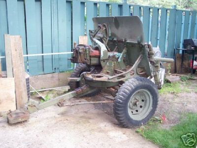

Hi Barry , thanks for starting this thread and I'd like to thank you all for helping me out with this ...the pictures you've posted will be a great help. I bought my first 1944 GPW in 1979 and never had any problems locating parts but ...I'm learning that this will be a whole different animal to complete. As far as my finding the seat and ammo racks ,I was hoping that someone knew of a junk yard or Scrap yard (with Military Vehicles) that might have a carriage still hanging around.
Here are a few shots of it being delivered to my backyard ...overall , it's in really nice shape. I'd love to know how it ended up here.
The maintenance Manual will be a big help (if I can find one) ...I'd like to change the wheel bearings before I try towing it anywhere for display ...still have to figure out what position the levers go in to make sure the wheels are locked on and don't fall off while I'm on the road!

That wood handle belongs to a garden tool ...the people who had it didn't understand that the mechanism had been cut and welded shut ..so they were trying to open it with the garden tools !

I know that this weighs in at 1700 pounds but , I've seen many pictures of Jeeps towing a 37mm AT Gun so ..I was thinking of using my GPW to tow this ..However , several of the "purists" out there say that they've never heard of or seen an American Jeep towing any Australian Equipment. Between the shortages and lend-lease equip ..at times I'm sure we were all using whatever was available and at hand.

I'm putting new Military ND Tires on it tomorrow and was wondering if the rims on my 2Pdr were original because they don't seem to match with any of the pictures. They remind me almost of the M151 style with the cut outs ..and at first , I thought they were mounted backwards . They look like they are off set ..but if I did reverse them , these rims would extend over the axle a little and cover the lever used to remove the whole wheel (& make the wheel base smaller).
Do you recognize the rims ? Could they be WW2 Australian ?

Mike, your wheels and tyres ARE Mutt items. The Aust 2 Pdr used commercial wheels and normal road tyres, not military NDTs. There were even fitted with hubcaps from a car! You should be able to find some Ford 4in x 16in rims with a 5 on 5 1/2 bolt pattern. The tires are 6.00-16.
Have a look at the AWM site and look through their collections database, using the search term "anti-tank". You will find plenty of pictures of the 2 Pdr in it's original form.

I hate to be a killjoy but judging from the photos of your antitank gun I would have to say it is a mixture of a British army type and the Australian type. I base this on the British style ammo rack mounted behind the shield.
These racks are totally different between the two and the Aussie one does not have the leather tool box sitting on top of the ammo boxes either.
I believe the Australian Army used both types and this shows in some of the AWM photos Tony put up.
Still a nice piece and I wish you well with it's restoration.
