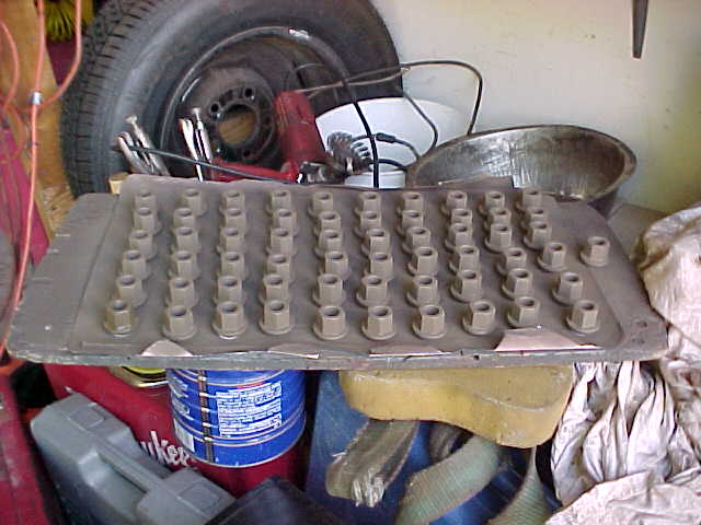

Having taken the weekend off was back at it today. We accomplished the following:
Donned our masks and cleaned out the asbestos from the engine compartment panels. Bagged it all for safe disposal!
Disassembled the windshield and found that the channels will need to be replaced. Thanks to Phil I have a way of accomplishing that easily by using an M-37 windshield frame! Thanks, Phil!
Began cleaning the lug nuts. all 72 of them!, in preparation for painting them. Have got 37 cleaned so far. What a boring, boring job!

Cleaned some more lug nuts; only 21 more to go (out of 72!).

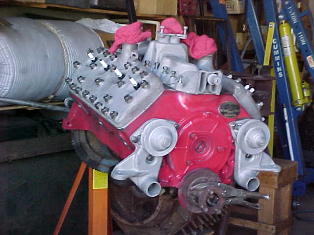

Picked up the engine night before last and hauled it home in my ancient Toyota pickup. Found that my seller had painted it a bright red in hopes of selling it to a hot rod builder. Have ordered the correct Ford engine green paint appropriate to 1940. Engine and it's innards look good. Will see if we can get it started! See the picture.
Began work on the engine by removing all the head bolts so that we can polish the valves. Lots of flaked-off rust in the water jackets and began to blow them out with some air from the compressor. Need to be sure we get that residue out before putting it back together!
Am giving some thought to going to a 12-volt system and having an electronic ignition/distributor installed. Will change to a negative ground system but with all the electric components out the only problem we may have is with the some of the original instruments. Any thoughts or comments out there?

the engine colour looks good since i'm colour blind, LOL check between the valve seats for cracking. my dad SiR HENRY rebuilds these engines and he goes through several blocks before he finds a good one to rebuild.

There's two places that the old flatties usually crack. On some cylinders they'll crack between a water passage and a head bolt. These aren't serious and a bit of sealant on the bolt will usually avoid having any problems arising. The ones that go across the valve seat and into the port are a different matter. They turn an otherwise good engine into a boat anchor.

cletrac, you can lock&stitch these cracks. also SIR HENRY is updating the valves with chevy ones.

[Began work on the engine by removing all the head bolts so that we can polish the valves. Lots of flaked-off rust in the water jackets and began to blow them out with some air from the compressor. Need to be sure we get that residue out before putting it back together!]
You are certainly making speedy progress Jim.
Please keep up the running commentary.
While you are checking out the engine you should consider replacing the 4 expansion plugs (frost plugs) at the bottom of each side water jacket where the oil pan bolts on. They are usually brass but some engines have steel ones that will develop pin holes. While they are out you can give the water jackets a real good cleaning.
Cheers, Terry

Thanks for the tip about removing the frost plugs. Will be working on the engine on Tuesday and knock them out!

Cleaned some more lug nuts. Am down to 6 to go!

Default Day 55
More odds and ends to report:
Picked up all the parts from the painter on Day 51; temp stood at 118 F so didn't even bother to unload the second pickup truck bed of parts! Locked it up and let it set until Day 53.
Took Day 52 off.
Dried out the tires and tubes where we'd got water in them while washing the tires.
Wire brushed all the head bolt studs, all 48, and then did the same to the head bolt nuts.
Brushed the valves clean and added some lithum grease in the stems to take care of the initial lubrication when we start the engine up.
Wire brushed all the bolts for the oil pan, intake manifold and water pumps.
Still no word from the spring shop so reassembly of the axles and brake system is on hold.
No word from the steel fabricator on cutting of the windshield frame. Probably not a high priority item with them....
Began reassembly of the engine by re-installing the heads, intake manifold and water pumps.
Got up early this morning and painted the lug nuts. Got to them before it got too hot. Will add a clear coat to them tomorrow morning.
Down to one helper and myself; the other called in early this morning with a bad back. Called this afternoon and should be able to some painting tomorrow. He's a college student and I'll need to replace him by the 20th of this month when he goes back to school. He's got a great work ethic and it'll be tough to find someone as good!
Rained this morning and the humidity was fierce today along with a temp above 105 F.
That's all for now!
Jim
