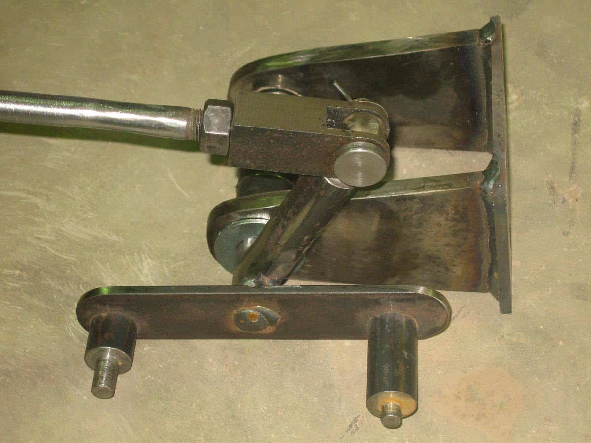

Hi all, a few pics of the gear change mech required for the 2 pound tank attack carrier and the Australian pattern mortar carrier. They are very fiddley and time consuming to make
Colin.

Tack welded into position to make sure all functions correctly. Still have to make the gear change handle and the bottom plate.
Just can't seem to find enough time at the moment.
Colin.

Wow, nice piece of work, but you sure went for the more difficult option in radius turning on that shaft. A well-known way (as described in Model Engineer and other places) for producing ball handles is to ....take a large ball bearing. Red heat to soften, drill through. Silver solder to shaft. Done!
Steve.
Old 22-08-08, 11:09
colin jones's Avatar
Posts: 1,810
Hi Steve, yes that is another way, but the hardest part of that, is finding a ball bearing with a diameter of 44mm. Even if you found one bigger it would be so hard to reduce the dia, but thanks for your comments.
Colin.

Nearly finished the gear change mech. I would have to say, if you never had access to an original mech, it would be really difficult to make a replica from pictures.
Colin.

For those of you who know what the original gear change mech looks like which is the previous pics I put on, this is the modified mech I have made up to accomodate the C4 transmission. A very simple system of rods and pins. It does change very easy and positive.
Just fuel, electrical and cosmetics left.

Very nice work Colin. I don't want to sound picky but don't forget about the movement in the engine mounts. Wouldn't want you to floor it and have it shift gears on you. Or break the shifter at the tranny.

Hi Ledsel, point taken. I'm hoping that I've got enought pin length to allow for 3 to 4mm lateral movement either way. I have also allowed 20mm under the mech for a rubber block to the floor. I need this for shimming to get the correct alighnment. If there is still a problem I guess I could always mount it direct to the transmission. The way I designed what I have, seemed to be the easiest way for a positive connection. I am still open to any help or suggestions. Thats why we put pics on MLU, to get help from experienced people all over the world.
Thanks Ledsel
Colin.
