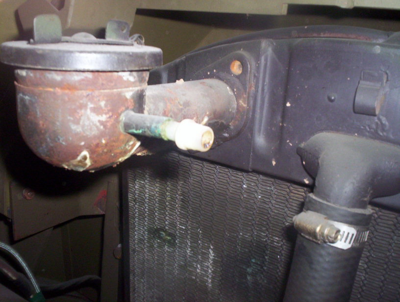

Default C8 radiator question
Hello,
The radiator on my cab 11 C8 is missing. Someone had apparently installed a substitute radiator in it at some time and cut a hole in the upper front right sheetmetal to access it. Is there a correct replacement radiator available for the truck? How did one access the original radiator to fill it?
Thanks, David

Posts: 6,036
Default pics
cab 11 radiator pics
BTW you are better off installing a thermostat as I got into trouble when not using one. The coolant circulates without any restriction and the upper header thak becomes pressurised as the coolant is forced into it . Coolant ends up squirting out the cap with gusto .. With theromstat fitted , problem solved . Thay also have a pressure relief tube ( which i still have to fit ) from the rear of the head to the filler neck .

Thank you, Mike!
Wow, I'm sure my local radiator shop will not have that upper fill fitting. Now I know why the previous owner added the access port on the front sheetmetal when they replaced the radiator. Will start measuring!
Thanks, David
