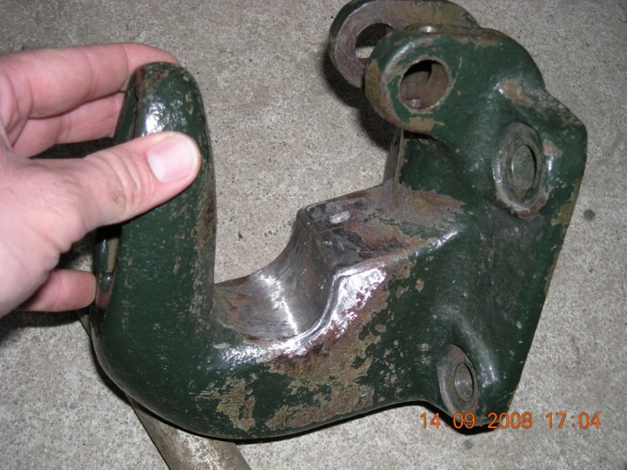

Hi Guys,
I need help vith repaire on my towing hook.
I have to velded the hook. The ovner before use on the hook the gas cutter.
Could I ask if is the parts vith radius or flat as show on the picture?
Thanks Radek

Hello Radek,
Here is a picture of one of my pintle hooks. Looks like just a slight radius. I used 5/8" bright steel shafting to make the latch handle.
Regards Terry.

Originally Posted by T Creighton View Post
Hello Radek,
Regards Terry.
Hi Terry,
many thanks for the picture and info what to use on the latch handle.
To all:
It is possible that the radius is made from trailer towing eye? It looks like so.
Radek
