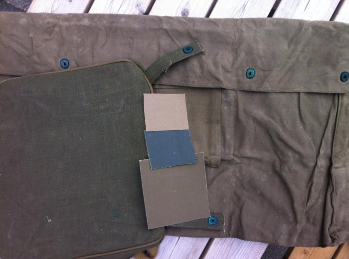

Tony,
You must be right about only externally visible canvas being available in different colours. Makes perfect sense and the parts lists proves it. I have looked up the canvas parts in the C60X and CGT parts books I have, and found the following:
  • C01Q7860052B (also listed as 5266144) / CUSHION ASSY., Seat
  • C01Q7860206B (also listed as 5800262) / COVER ASSY., Seat Back Cushion
While for the seat canvas no colours are listed, the following come in Matte Green, Brown and Light Stone (with different part numbers):
  • CURTAIN ASSY., Cab Door
  • BAG ASSY, Curtain
Interestingly, although the Curtain Bag is an interior part, it comes in three colours like the exterior Cab Door Curtains. Most likely these were supplied from the factory who made these canvas items in matching colour sets.
Attached goes a picture of my NOS seat cushion and NOS curtain bag, topped off by some canvas samples I got at War & Peace. The top sample is a light tan colour, the middle one is too green for Matte Green and the lower sample comes close to the curtain bag - which is Matte Green or Light Stone? Clear as mud.....

this is the color of the only NOS one I have, kind of a light tan.
Harry,
Looks like your tan seat cover fits the Light Stone bill....
