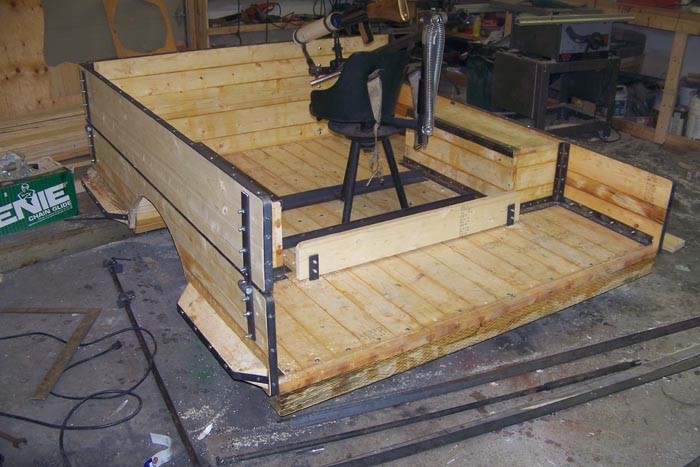

Old 28-02-09, 04:30
It might not look like it but I did clean the shop up but then got back at it again. The box is starting to take shape and is looking good. I'll have to try the Motley mount out for size one of these days. Maybe after I get the front and sides done.

I put the Motley in the back and it looks pretty good. There's a couple of angle irons that go the width of the wheel wells to mount it using the same holes that the division boards use. I still have to do some work on the wheel wells, then the fold down sides and endgate and the tool box but the end is in sight at least.
When I was looking at the setup, something came to mind. When I'm done, will this be the only complete AAAT1 in existence? I know there's several Cab 11s with the 2A1 but I've never seen any mention of any with the anti aircraft mount in place. There's also some Motley mounts but none are in a truck except for the one somebody put in a C8. It'd be kind of nice if it ends up being one of a kind.

Old 10-03-09, 05:13
I put the angle irons on the bottom of the seat legs. The seat bolts to the angles and the angles bolt down in the division board holes. You can move the seat ahead or back using these holes but any pix I've seen has it mounted on center anyway.
On checking out some of my 2A1 pix I see that the Canadian box has more metal edging on the panels than the British trucks. I had to take the sides off to put the edging on them. I started making the side hinges so should start on the top side panels tomorrow.
