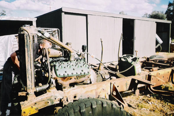

Here are some more photos from when we first moved the trucks over to our place. The monkey face was definatley shorter than the others, there was only one piece of drive shaft going from the transfer case to the rear dif. We managed to save the rest of the drive system from the others so its all together now.

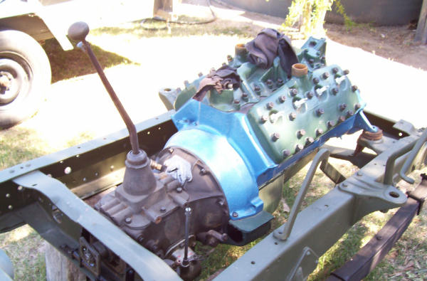

Where possible we used all the running gear, diffs, transfer case, gearbox, engine etc out of the monkey faced blitz since it actually still worked. At least one oddity of this is that the front diff has the larger 6" wheel knuckles/steering system, and seems to be of more heavy duty construction.
The Engine ended up that mixture of Ford Blue and army green because thats the colours we found, on all three engines. What colour were the wartime V8s painted when they rolled off the production line? The same colour of the vehicles?

The Monkey Face is a 12 Cab F60S with Winch. The wheelbase should be 134".
And you're cannabalising that to get the others goin'?

Tony, the monkey face has the chassie plated so maybe it has been alted at some time
Jim do you have any photos of the monkey face chassie for as far as I know cab12s didn't have the extra plate on the chassie
Jim good to see that you are collecting fords
Max

I'll see if I can dig some photos up but dont hold your breath, but yes the chassis is plated, internaly as well as on the outside, you get the impression that it broke its back at some point as it has been crudely reinforced inside the U of the frame rails for most of their length, that or it had a severe beating/strain put on it. The running gear and some front sections of the cab were really the only things intact, the rest was either rusted through or cut and welded together...or both, it was not as nice as it looks.

I'd suggest given it's chopped and plated history it may well be a shortened F60L, poor old thing.
Are there any surviving data plated on it?

No, there are no data plates remaining that we could find. Here are some photos of the underside. On turning it over you can see it is very modified and very damaged. It looks as though some of the spring stoppers and mounts have been bolted straight onto the plate on each side. The winch cross beam is the correct one, but either it has been put in as a modification or reinforced. Considering that there is a big hole cut in the other cross piece I'm guessing its the former. To be honest we haven't paid much attention to the cab 12 chassis as it is in this state, and we've been working on restoring one of the Cab13 f60L trucks, but the cab 12 truck lives on in the running gear of the project.

Yes, looks like it's had a winch kit or one from another vehicle. Trucks factory fitted with the winch (Talking about Fords here) had a double rear cross member and extra fish plates.
Old 25-02-09, 01:42
And the brackets where the the winch pillow blocks were mounted to were welded into the chassis rails, while Chevs were rivetted. Yours appears to have bolts.

Youre right
That is one ugly hatchet job on that chassis
