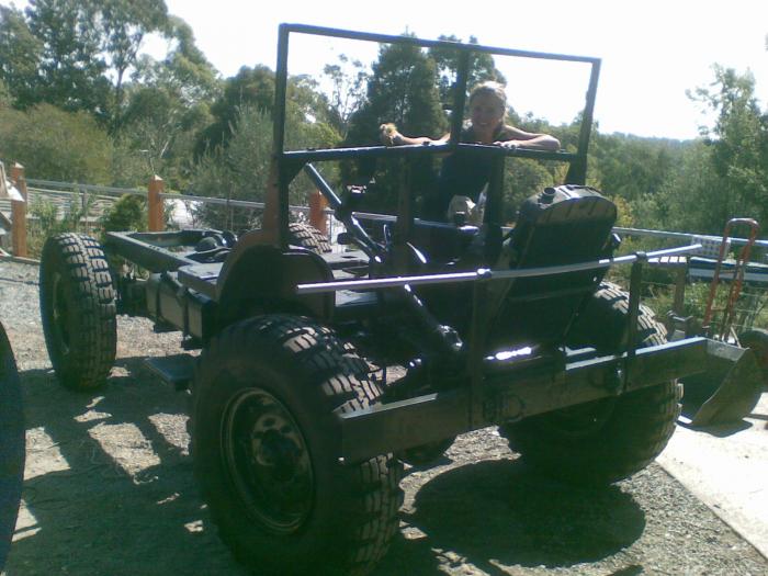

Hi all, Too long since working on the C15 but got the house to lock up so i can get back to the real job at hand.The base of the cab went on and back into the shed she went.Front nose is on and guards,today i worked on rebushing the compressor as it had a severe oil leak.I found on dissassembly the big end bush had come out and allowed the oil to flow down the oil hole and fill up the crank of the compressor and out the breather.Also the breather wasn't sealed to the pot so i sealed it all up and hopefully it holds oil.Hand brake all done and finishing off the transfer shifter assy.Note the poor old white Chev in the third photo has been robbed of her front diff no more outings for a while. ( Thanks to Euen the fun police)

Hi all Progress photos below.Bobs excellent reco job of dash in the foreground.Note the oil preasure of the one i just got and it has an electronic temp gauge.Feel free to let me know.The new loom was made by Vintage Wiring Looms of Ringwood Paul the owner is the easiest bloke on the planet to deal with nothing is a problem for him.

Hi All,Sunday night resting up from the best weekend i have ever spent with the nicest group of people you could meet.Yes the Chev was finished good enough to drive her to Corowa on the Friday,In total she did 650klms return trip and all trouble free.On the highway she sat on 90-95klms and the top speed was 105 klms but it felt like she was reving her head off.Total fuel usage was 160 liters which i felt wasn't too bad considering i havn't realy given her a good tune up.Next step is to sort out the tray and fairleads .oh and get some better seat so my bum doesn't burn after the first hour of cruising.Thanks again to all that made our weekend as good as it was we look foreward to getting to know you all better in the near future. John Stokes (Note my crazy neighbor)
