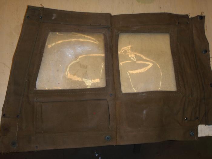

Top fasteners are for clip on piece were side screen rests against , see my picture of top of cab , it is an original one . It is flat canvas with a round rubber stitched into it .

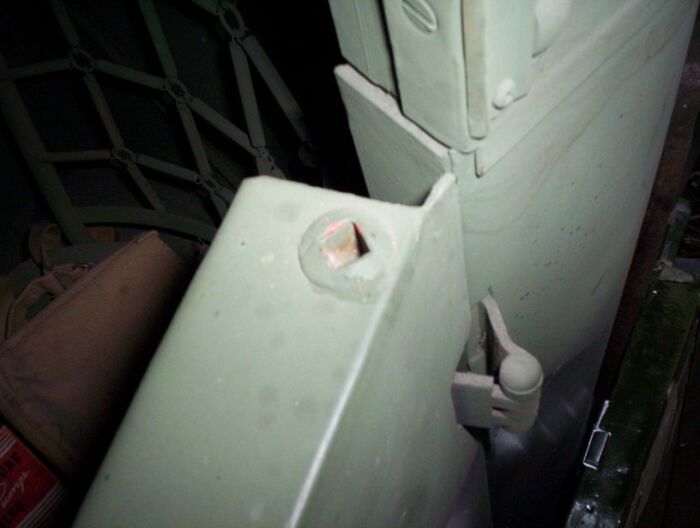

Old Fords and other Old timers have that same square socket in the doors for side screens , and they also have round rods for the sreens , Square sockets make sense so the rods don`t jam that easy.
if somebody needs more pictures of the top canvas piece let me know , also a picture of how the rods are in the side screen.

here pictures from reaf of curtain with rods in . the first is of a dark stone collored one.

I Stiched new window plastic in the ones I have in the truck . I also have a set wich is collored in a dark desert yellow . And I have from the same material a radiator cover.
The rods are solid and round even at the bottom .there are little tubes welded on the top ones corners, so you can slide the upright ones in .
if they are mounted , the screen is a nice tight fit in the cab , but if you unbucle the 3 doorfasteners , and lift it out the two upright ones fall out of the bottom of the screen . In practice they went in the mud , to not be botherred about anymore . You have to take the 3 rods out off screen so you can fold screen double and put it together with the rods in the bag behind driver.

Ill stick with this thread because I am attempting to get the rods and curtains spot on with new reproduction materials.
Part of this involves getting the rod holders in the doors right.
I just rang a die cast place who suggested the mould may cost $3000!!!!!!
My next question is obvious - does anyone know where there may be some new old stock ones???
I have tried the ones from Mac's that suit Model T's and A's but they don't quite fit properly.
Suggestions??

Tony
You need one of those drills that makes square holes ��
There is a process called broaching, https://en.m.wikipedia.org/wiki/Broaching_(metalworking) square holes are made possible . Would it be possible to fabricate new sockets from aluminium or brass stock rather than a casting process ?
