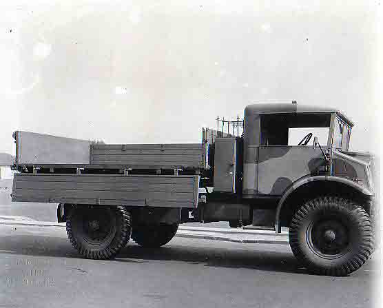

I'd have to see a photo to see which type of tipper body you have for sure but I have one photo where I can see that the back tail gate has a steel covering on the interior but the wooden sides do not. Unfortunately none of my photos show the deck area on the inside to see if they were lined with steel. Not sure where I got the photo's below but they are labled as 'Dual Purpose' Tipper/GS. In Photo A you can see the steel lining of the back tail gate.
That was the one I was thinking of. Those pics were taken at Wesley in Melbourne.

You have the more normal type and the photo below shows that it does have a steel deck inside. Photo is from Pictures Australia and is from one of the State Libraries. It has always been my understanding that this type of tipper body was all steel.

here is another photo of the same truck as above. I have used photo shop to lighten the shadows under the deck and it appears to be an all steel body to me. Photo from the same source as above.
Absolutely, this one was all steel, a Tipper No4 of 2 1/2 cubic yard capacity.
