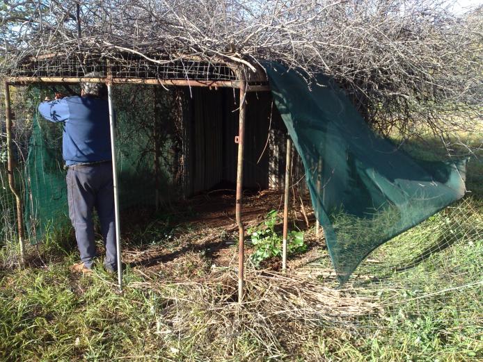

Well, after much frustration, we've managed to remove a Fire Brigade modification from the Blitz; a rod set in one of the canopy frame holders to hold a spotlight. It's been set in rubber, and would not be moved by persuasion or brute force. We welded a bolt to the top of it so that we could wrap a chain around it and give it something to grab on to, and we then lifted the rod out with the tractor. Believe me, the truck was almost half a metre off the ground before the rod yielded and came out. In the end, human ingenuity prevails!! :P
Now the trick will be removing what's left of the rubber from inside the canopy holder...
And in breaking news, I've managed to locate the original canopy frame itself that went with this Blitz! It's also located on "Willanthry", and is doing service as a damned trellis! Luckily, the modification is not extensive, and if i could persuade the owner to part with it, i may gain it for my truck.

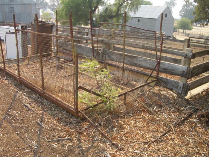

I received the word from the people i bought my Blitz from that the canopy frame that belonged to the Blitz had been transformed into...a bird cage! Thus, in the interests of keeping the Blitz as original as possible, i acquired the canopy. The catch, of course, was that it was in the condition that you can see in the photo below. After a day's work and much cursing, my dad and i freed the canopy, and we've got it home.
Also, i'm posting a couple of pictures of the extra spare tyre carrier on my Blitz for a member of this site named Peter.
Does anyone on the site know which way around the canopy goes on the tray, out of curiosity?

You may get some clues off this frame with the rear door still attached.

Ah, those are great photos! I thought that the end with the dog-legged poles must go to the rear, but i wanted to be sure.

Well, today myself and my father attempted to put the canopy frame back in place on the back of the truck. Unfortunately for us, it turned out to be too heavy, too awkward and too big for us and our poor old Deutz-Fahr tractor to handle. We've wrestled onto the back of the truck, sitting athwart the tray, and once we get some more hands out to help, we should be able to put the canopy into it's slots.

With our faithful old Deutz-Fahr tractor, we've managed to put the canopy back onto the back of the Blitz. It didn't want to go, and after a few bent posts and some frustration, the canopy is back on the Blitz, after about 50 years of separation!
