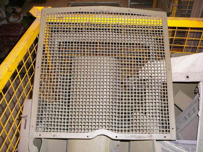

There are quite a few differences between ford and chev
the most basic ones are
-Chev diffs are banjo style (having a full case with the crown/pinion/input shaft plate bolt on the front and plate on the back) Ford has a split type diff(frrom front to back)
-Chev have 6 cylinder engines Ford has 8
-chassis are different and engine mounting points are different ,chev at the front, Ford to the sides
-Chev brush guards have legs front and rear of bumper Ford mounted behind bar
-Generally (in 13 cabs) Chev grills are extruded mesh Ford are woven bar
The nomenclature plate in 13 cab generally is above the speedo to the right side of the speedo facia panel ,you should see 4 rivet holes in a rectangular pattern if removed

You may not find any number stamped on the chassis at all, that won't be in any way strange or unusual. If there is one, it will be on the forward part of the left chassis rail between the front spring hanger anfd the bracket for the cab mount, either on the face or top edge of the chassis rail. There have been instances of the number being in a similar position on the right ch rails.
If your truck looks like Hanno's pic, we can eliminate it being an MCP. It is a '42-'45 13 cab F15 Blitz!
The data plates (Canadian factory = Tin/Zinc) should be on the top surface of the dash above the speedo, as shown on the 2 examples pictured. The Aust Army nomenclature plate (Brass) will be on the engine cover, either on the rear facing sloping panel with the handle, or on the side facing the driver. (I've pictured my Jeep one for clarity )
In the absence of any data plates or chassis stamping, establishing the identity of the truck will come down to determining the year and engine number (Am I asking a stupid question to inquire if there is the remains of any painted number on the cowl either side of the bonnet?) Again, finding the engine number is not a sure bet! It could be in a couple of places on the engine or the gearbox as shown.
