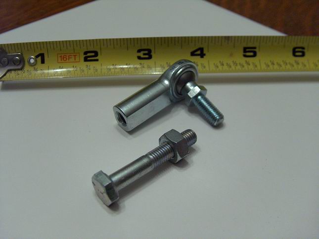

Hi Dave
Here is the first of 3 pictures...comments on the last email...
Old 27-04-04, 04:01
Posts: 5,267
Default number two...
Hang in there...
Old 27-04-04, 04:08
Posts: 5,267
Default ... and 3 ...
.... now the bolt is a 1/4 inch.. we refer to as 14 - 20.... which is the same size as my linkage rods which are threaded.. and just there for comparaison....
Note to watch..... on end of the rod is RH thread the other end LH thread and you have to get the right pair to be able to adjust over all lenght..... the female thread is also RH and LH...
Now these are not original M-F parts... the dealer gets them from visiting jobbers... he selects what he knows are needed for general application.... needless to say they come in various sizes as well.
If you get stuck sourcing these parts I will ask my M-F dealer to get me some manufacturing or distribution leads.....
Good luck and let me know how you made out.... I may revert to refabricating the throttle linkage on my C15 cab 11...

Dear Bob,
that is very close, though not a "quick release" or perhaps "detachable" is a better description, it is in 1/4"- 20 (UNC 60 degree pitch, no doubt) which can have the threads chased for 1/4 BSW (1/4 - 20 but 55 degree pitch). This has potential, too. I am trying very hard to only have BSW and BSF nuts and bolts on the car as it less confusing.
The SS version I posted also comes in zinc plated steel, which is a lot cheaper but that particular image showed the configuration better. Depending on the size ball required I may be able to re-thread a 5mm to 1/4 BSF (1/4 - 26, 55 degree pitch).
Note how the spring wire clip retains the ball in the socket. The type used on the Daimler is very close in profile and basically differs only in location and shape of the clip.
This is very good information you have provided, and gives me quite a selection to choose from, now. I just have to examine the mechanics of the control rods.
