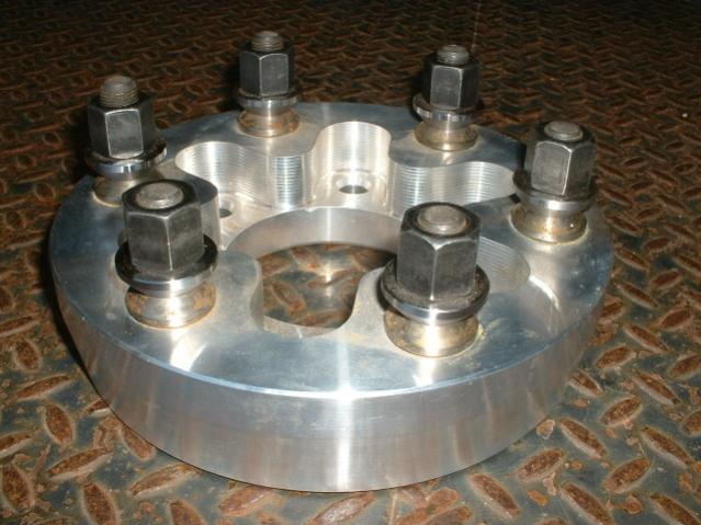

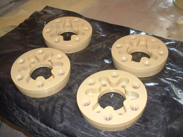

Default wheel adapters....
Today I received the first sample of the C8 rear wheel adapters that I had made. As I don't have the correct front axle or hubs, I will need four to mount the original C8 wheels on my truck.
Made of 6061 aluminum. Had the double sided cone washers made also since I couldn't source them from anyone. Still uses the original C8 lug nuts, although they will all need to be right-hand threads.
Fit great, so gave the OK to make the rest.
Had two extra adapters made if anyone needs a pair.
Oh, if anyone need a set of the Trelleborg tires, there are still 8 sitting in a warehouse in Georgia, and I bought one extra that I won't need, so.....
Thanks, David

Default baby steps...
Haven't had much time to work on the C8 lately, but slight progress has been made.
Although the original lug nuts ran down the 5/8-18 threads on the new adapter studs OK, they seemed slightly loose. I assume the originals are BSW thread?
I didn't have enough lug nuts for all four new adapters anyway, so had these cone washers made up using an original lug nut base as a pattern. Sourced new nuts to go with them from McMaster-Carr that, together with the washers, look close to original lug nuts I think.
So now I finally have the tires, wheels and completed adapters to put on the C8, but with my current seven-days-a-week work schedule, I can't find the free time to install them!
Thanks, David

Default better progress...
Hi,
Had enough time this weekend to sandblast, prime and paint my wheels for the C8. Lots of rust pitting evident on one wheel after blasting, but a pitted wheel is certainly better than none at all.
Cleaned up the three original liners I had and used a new 16" liner for the fourth one. Cut it opposite of the valve stem hole and tapered the edges with a grinder. I believe David Pope had suggested this on a previous posting. Worked like a charm. Thanks for the good information!
Are the red nuts correct for the C8 wheels?
Also prepped and primed the adapters with epoxy sealer, and painted them. Hope the paint sticks as I have had problems with painting aluminum in the past....
Thanks, David

Default Well done David...
I never realized four 13 inch rims/tires/adapters could look that good ! I am finding this thread as well as Davids a wealth of information. Thanks Rob
