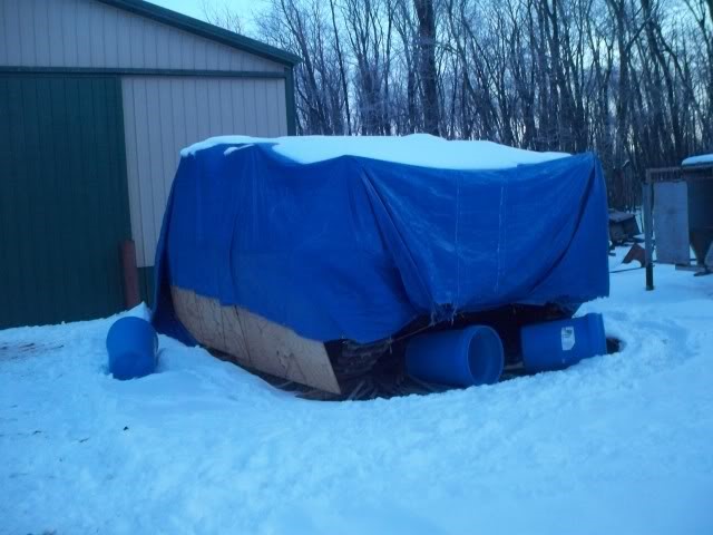

Here are some pictures of the Sexton I brought home in June 2009. Jesse. ***NOTE***On 8-5-17 I re-added all the pictures that were lost when the picture host changed their policy. There are actually more pictures now, but some may not match exactly the subject of the individual post.

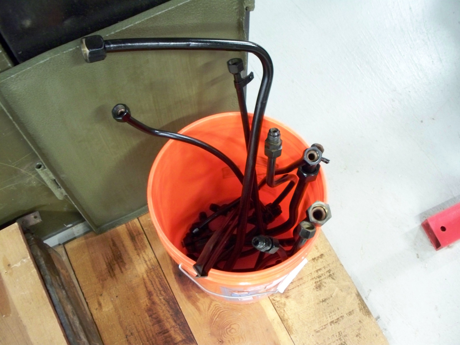

A new bottom for a 50 gallon tank.
This came from the first step in the washing process for all the drive train bearings, and internal engine Parts.

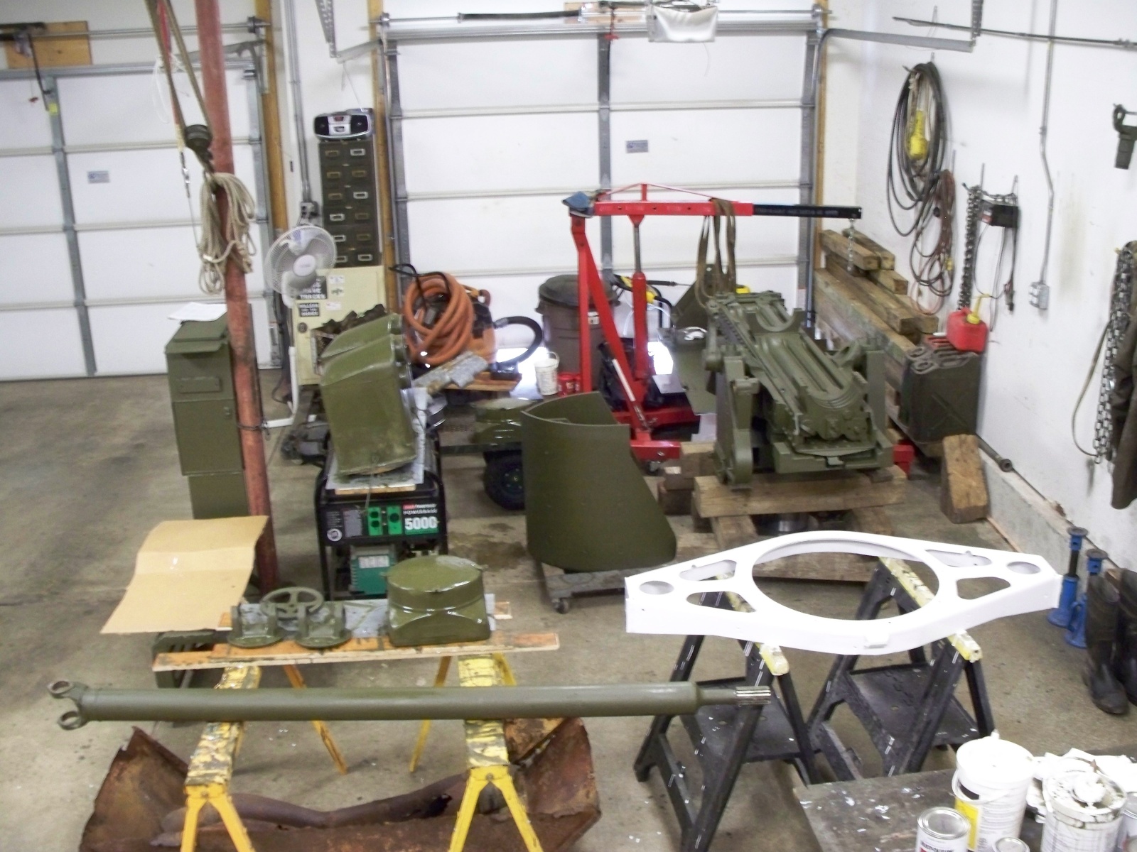

Weve been working on the vehicle itself for the last two weeks. Inside is finally clean, and mostly painted. Installed the gun today in the rain. Waiting for Some cylinders to be chromed, and some rings. Jesse.
