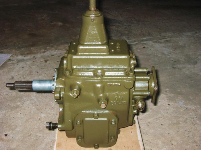

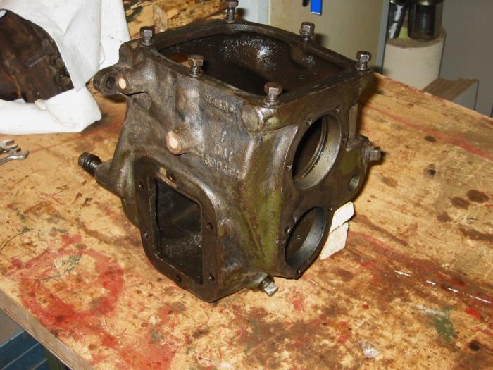

Default more transmission..
here some more pictures of the transmission.
versnel huis 1.jpg   versnel huis 2.jpg   versnel bak.jpg   versnelbak 3.jpg   versnelbak 2 (3).jpg

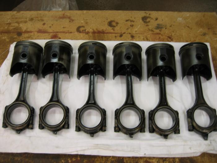

now the enginehead is done I could start on the crankshaft. when I drained the oilpan there was some slutch in it, so that needs cleaning. I opened the rod bearing caps and took out all of the 6 pistons and checked them for wear.
as you can see the no 3 piston rod is bent a little ?
there was nothing else bent or damaged luckely. after the pistons were out it was the turn of the crankshaft to come out, so when it was out I could check it to and there was a little bit of wear on the main bearings so that means up to the machineshop with the shaft for some new bearings.so I took the flighwheel of the shaft after I marked the two first so I can put it back ad the same position. I found a machineshop near my house which could turn off the crankshaft to the new size. after some mesurements it was found that the shaft was still the standard size and have to be turned off to the size 010". so the next thing for me is to find some new bearings.
when I have them he can start the work on the shaft.
so up on the internet.
cheers jaap

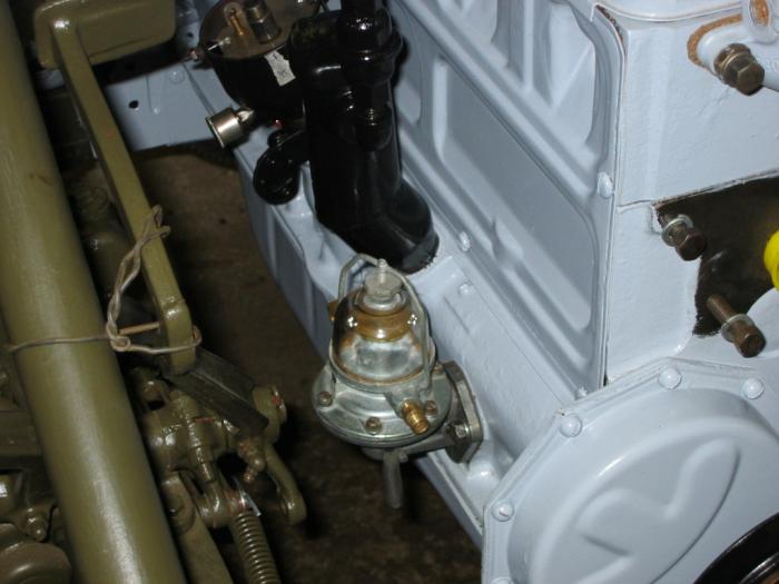

now the engine is in place the generator and starter have to be installed.
the generator i took apart for cleaning and replaced the bearings, reconnect the wireing it was in big nead of this. for the starter I did the same.
the fuel pump, I cleaned to and gave it a new membrain, gasket and installed it in it's place. the waterpump was next it was in nead of a new bearing and gasket I used a press to install the new bearing and put the pump together and placed it on the engineblock I used liquit gasket so it (I hope) will not leak. the intake and exhaust manifolds were bolted on useing new gaskets and rings in the intake ports. there is a new thermo spring on the thermovalve in the exhaust (hot spot).
it starts to look like a engine again, but will it start ???
cheers jaap

on the bellhouse there are 2 wholes with tread that I could use to attach
the filter bracket. I had to ajust the filter a little bit so it is cloose to the engine. there is a 3 way block on the engine to house the oilline and the oil gauge line, this was difficult to get. for the bracket I used a angle iron to keap it simple and I am happy with this, easy to get to the filter.
cheers jaap

First very neat work, but before you go much further be sure to mount the exhaust pipe and check for clearance. If your exhaust header pipe is the one that curves forward then back you should be fine. You may also find that you need to put a heat shield on your rubber lines.
The air flow is very restricted in the Pattern 11 and 12 Chevys and the passenger side engine cover is very tight to the exhaust manifold. The result is when the truck is run at load it gets real hot in this area.
I've got to find the link but there was an earlier thread about the later location of the military filters which was at the rear of the engine above the intake and exhaust not a convenient location for the Pattern 11 or 12.
Also I'll dig out some photos of the clearance issues on my Pat 12 C60L. The original filter location is in the left hand frame rail on it's side a really nasty place to drain clean and replace. Plus the oil lines run close to the exhaust.

thanks phil for the info on the filter.
I think that to place the filter at the back of the intake manifold will not fit because the engine panel (speedo gauge) is to cloose to the engine so the filter will not fit I think. and I see the picture of the filter place on it's side in the frame rail, but I don't like that overthere.
the oillines are about 5 inches clear of the exhaust pipe, but a heat shield is not a bad thing I think, thanks phil.
so I hope the filter is not getting to hot on this place I will keep an eye on it.
thanks jaap

From the pictures it looks like you had already check the exhaust pipe clearance. Very good detail work it is a lot easier to work these things out before the entire body is mounted.
Is your exhaust new or a good used one? Is there a source for Chevy pipes in your neck of the woods?
Enjoy watching the progress.
