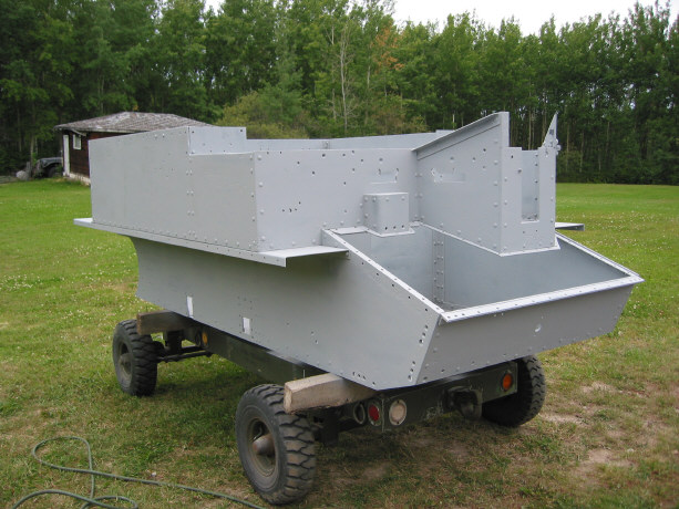

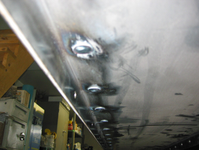

It has been some time since my last update but I have been able to put in some time on it this year. This spring I was able to install the new mud guards I had made up as the old ones were removed from the previous owner. It was a lot of work to drill over 200 holes for the rivets and the bins and about half of them were counter sunk.
213-1350_IMG.JPG   213-1352_IMG.JPG   213-1358_IMG.JPG   213-1359_IMG.JPG   213-1360_IMG.JPG

Some more pictures of the newly installed mud guards. I also recruited the help of my dad to hold the bucking bar.

This last week was a great week as it was very nice weather that we did not have for most of this summer and I was able to do some priming and painting of a lot of the parts including the tub.
219-1967_IMG.JPG   219-1969_IMG.JPG   219-1970_IMG.JPG   219-1971_IMG.JPG   219-1975_IMG.JPG

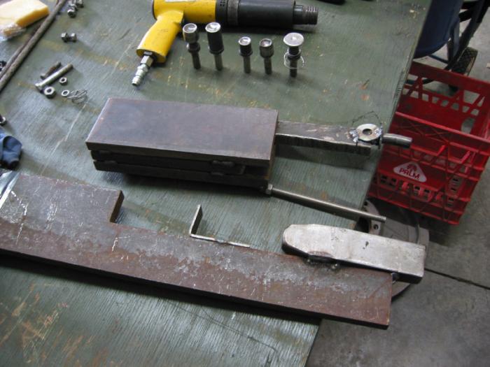

dave what did you use to set the rivets...any pics of the tools ?
I used a 8x rivet gun and made up the bucking bar with the rivet sets. If I get a chance I will try and take some pictures of them.

Yes please can we pictures of the tooling (gun dollies bucking bar etc.

Ok Here is what I used for the bucking bar and rivet sets. I purchased the rivet Gun and the Sets off of Ebay (just search for rivet sets generally in the aircraft section) in two different auctions. The rivet sets I purchased came as a bunch of 27 pieces, but I only have been using 5 of them as the others are to small but was cheaper than buying them individually. The bucking bars I made up and added the extra weight to them as my dad was giving me a hand and he did not have the strength to hold the bar tight enough (he is 80 after all). I made one using a offset rivet set as drilling the end of a piece of steel and holding it in with a washer welded on so it would not fall out and the other piece was drilled and then shaped to what I wanted with a round grinding stone with a die grinder.
220-2003_IMG.jpg   220-2004_IMG.jpg   220-2005_IMG.jpg   220-2007_IMG.jpg   220-2008_IMG.jpg

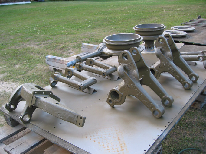

Well this week was another good week for getting some more painting done on most of the suspension and differential. It was a low as the last rear swing arm I was dismantling is totally seized on the pin and I can't get it out . I tried heating it up and putting it in the press with no luck what so ever. I tried hammering it with a large sludge hammer and a punch for a hour and again no luck. after realizing I don't think I will ever get it apart I was lucky to have another rear swing arm that I was able to strip down and remove the pin (Again I had to use the press and heat to get it out, but it did). The bad was that the pin is in very poor shape and I will have to see what I can do to make a new one (unless a nice fellow member out there might have a spare one ) as the other 3 I removed are in great shape. Also what has other members done about the bushing (for the better lack of word for it) that the end of the spring ball shaped retainer goes into as I have a couple that have nothing at all left of them ???
220-2013_IMG.JPG   220-2014_IMG.JPG   220-2019_IMG.jpg   220-2029_IMG.JPG   220-2030_IMG.JPG

The suspension swing arm, the bushing and one of the good and poor shape swing arm pin
220-2054_IMG.jpg   220-2057_IMG.jpg   220-2051_IMG.jpg   220-2052_IMG.jpg   220-2055_IMG.jpg
