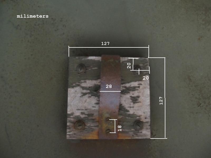

Default plotting board mounts
Here are few pictures of cab 13 mounts with dimensions in milimeters
