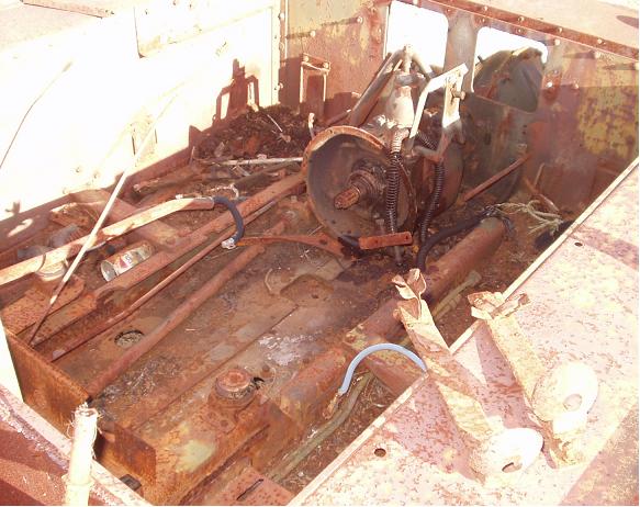

Hi, Nice find, In your third photo, those two round clips on the rear compartment deck, left hand side, one clip bigger than the other, does anyone know what they are for?.

They are for the jacking bar. I too would be keen to buy the folding armour, hinges, locking handle etc.

hi, thanks, has anyone got a picture of the jack bar, is this for the track jack or the main lifting jack?.

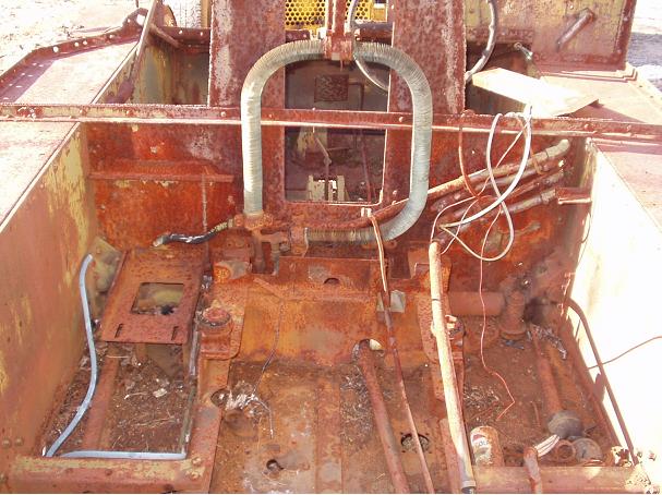

I think I should reconsider my plans..... she's going to need a new floor too..... It's a little thin in places. You chaps are talking me into it. I will get some close-up pictures of a couple of unusual features I found today.
Here are some pictures of the the other hull. It has a lot of conduit in it. We are quite sure the hull # is 8193c. The small c is quite clear and the #1 has definitely been stamped over a 2. I can get a better picture with another camera if needed, in case I got this wrong.
I also bought her engine, from Dan and a few bogies wheels, also a radiator. I also got a remote oil filter but he was not sure what it should look like and neither was I. It looks like the oil filter on a CMP I looked at yesterday. Phil
Hull # 8193 front.JPG   Hull # 8193 middle.JPG   Hull # 8193 middle front.JPG   Hull # 8193 rear.JPG   Hull # 8193 trans.JPG

The jacking bar goes into the cross tube, for lifting the side of the carrier on a jack. To make it less boring, here are pictures.Note this may be for an Australian carrier. Much the same but different diameters. My cross tube is a shortened LP2 tube, in my English A.O.P.

Thanks everyone for the all the information. I checked yesterday and the shifter housing is missing. I did get 2 more pictures inside #777. Phil

is that the smoke discharger handle mount on the first pic Lynn ? if so this carrier has everything ha ha ha

Richard H.???????? Post no. 23 is the jacking bar.
Phill, you early production carrier is of Canadian manufacture. I revisited your photos.
Can someone identify the brackets for me in the last photo Phill has posted.

They are left to right, the smoke launcher cable holder. That bike style cable would fit in the slot in the tube then its out of the way for the radio and less chance of getting snagged on other stuff. The next one is what the smoke launcher handle attaches too. Its flat steel in the shape of a "T" with a tube welded on the end. The next one is the bracket for the flare gun holster and grease gun hose. On the back of the flare holster there is a wide strap and it slides over the bracket. There is also a spot for a grease nipple to thread on. Obviously there is nothing to grease there except the back of your blouse, but the hose from the grease gun hooks onto it and then goes down the rear wall under the seat to the grease gun in its bracket.

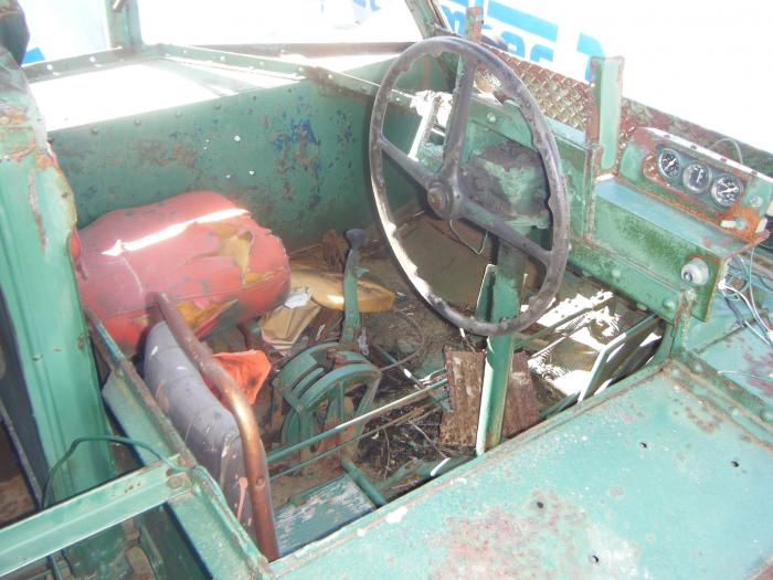

Jordan, thats an English clutch pedal(with welded on strips of non skid) in your 2nd photo. Have you a picture showing the bed rails of this carrier? This would confirm its origin. (what about you Phill?)
I make the assumption that the clutch pedal is English, because they are the type usually seen in the hulls with the sharp edged (channel) bed rails, as opposed to the chequer plate type pedals seen in the Canadian hulls with the rounded (roll formed?) bed rails. Another difference between the two, is the lock out lever for reverse on the gear stick. one is a short rounded alloy casting, and the other is a longer skinny steel lever.
