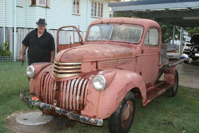

Have the Chev home, could someone assist with year model & where it was assembled, It has green paint under the current red oxide & a star frame on the front bumper, original numbers on the plates are as follows.
Plate one
Body C1827
Chev Cab
Series D
100-No
Plate 2
Colour D L X
L Stone
Batch N0............ nothing here
Date C I
Has painted out numbers both sides of bonnet , i will get it on the hoist and try and find chassis numbers

Hi Obby
The chassis number should be near the left front spring hanger facing out .
This should have a series of numbers followed by a letter which may indicate what state it was assembled in .

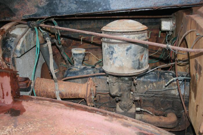

Looking at picture 2 there is a holder for a military fire extinguisher , the dash indicates it may be early forties where as the chev's assembled late in the war and in 46 had the military dash with round individual gauges.
Jim S.

It appears to be a 1941/42 but for the model you need to measure the wheelbase as there is only an inch difference between several models.
Old 01-05-10, 23:51
1941 was the first year Chev put the headlights on the top of the fenders like that. Earlier trucks had them mounted to the sides of the radiator tin. In 1942 they quit using chrome on stuff since it was required for more important things so yours should be a 1941 model.

Centre of front hub to centre of rear axle 115" , could not see the chassis number will have to scrape all the grease off the chassis in that area , do you know if it is possible to buy a workshop manual for these old Chev,s.

I think your truck is a 1942, Model BE, Commercial half ton truck. The park lights on the top of the headlights were different for the 1941, Model AK, commercial half ton truck.
Yes I agree ..looks like 41 or 42 . Holden initially made these with a seperate cab/body but later on , around 43 , they went over to the typical ute style one piece body . Some of these early Holden bodied examples went to the Middle East as seen in the AWM pics. here
http://cas.awm.gov.au/item/025161
The light Stone colour on the tag indicates for military use . The wheelbase will be 115" or thereabouts.
The next size up is the 1 tonner on 17" wheels with 123" wheelbase . Interesting find .
I just realised " C1 " indicates MARCH 1941 assembly making it a very early example, possibly one of the very first Holden did with the 41 style front end .
D L X indicates DULUX paint .

Being a Canadian / Australian vehicle this would most likely be a model 13 , 15cwt with 16'' wheels where as the 1 ton model 14 had 17'' wheels .
Certainly a good find and well worth restoring to original.
