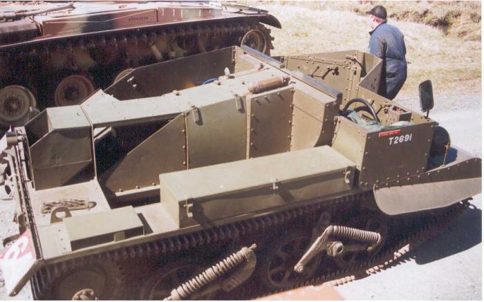

Do you mean this box here? It looks like there was one for nearly every type of carrier built, Scouts,Brens, Universal Mk1(*), Mk2(*). The Aussie LP1 even had two (One was deeper)
A question for you (or anyone else)What went in the bracket in the corner of it? (see the fourth picture)

just looked in Vol .1 on page 238 what i thought was the battery top cover is the floor board as per Jordans comments, it also had the bren tripod holder on the same bit of wood too.
