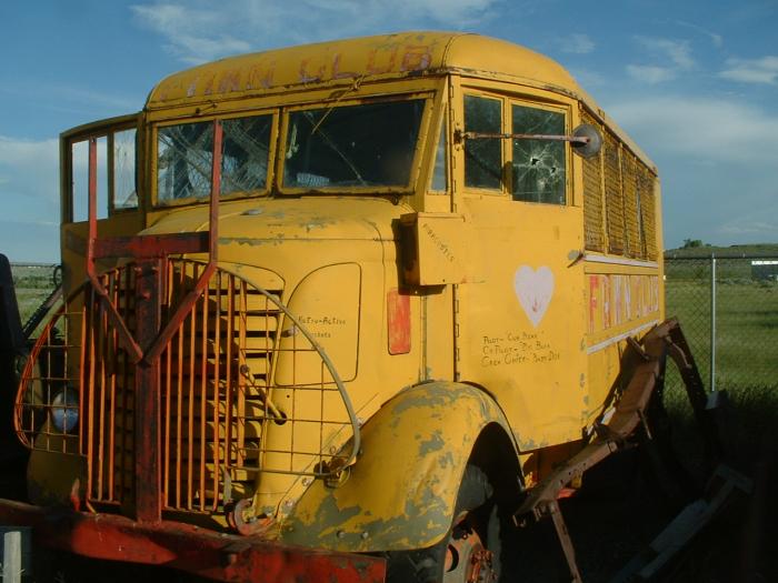

Am trying to locate the owner of this very nice GP Jeep in New Mexico. It was for sale, but the sign had rotted off the windshield and the phone number was unreadable.
The AFKX 352 I have known about in Wyoming for a few years now, but it was a little pricey, and would take a low-boy equipment trailer to move legally, so I decided to pass it on to a man with the money to do it up correctly. Found it's sister in an old scrap yard the next day. They were both apparently used as rural school buses in the area years ago. I have a friend trying to deal with the eldery lady who owns the yard, so we'll see what happens.
Picked up this very straight 1.5 ton ex USAF Chev, but had to leave it in Nebraska. Will probably go back for it later in the summer.
Also found this modified T-16 and several half tracks in Nebraska, so will try and find out more information on these when I return to the area.
Thanks, David

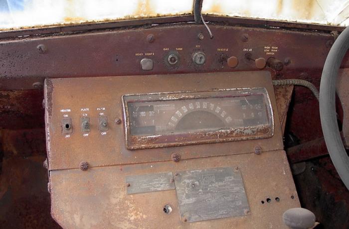

Received a set of nice toggle switch plates and a dash jewel for the C8 from Brian Asbury, (thanks again, Brian), and found a set of suitable ball-end toggle switches from the local hardware store.
After looking through some cab 11 dash photos, I have a question about the order of the switches. I placed them as "instrument", "tail" and "stop", but would that be the correct order for a cab 11?
Thanks, David

Default Here is what I have in my photo archives
...picture taken at Coe Hill in 2005...... although truck had termianl cancer the interior still showed a good instrument/switch layout..... now this is a C8 and maybe different for a C15a.....
  #202
Old 13-07-10, 03:35
Posts: 5,267
Default Another version....
...so which one to believe....
This one is from my own cab11 C15a.....
First is STOP..... second is TAIL... and the 3rd one is a double sided swithc with a neutral in the middle labelled INST........
  #203
Old 14-07-10, 03:44
Join Date: Sep 2005
Location: Plano, Texas
Posts: 357
Thanks a lot Bob for the photos!
I'm going to go with the switch order on your truck in the second photo as it looks to be unmolested. Wonder why the three position switch on the instrument lights?
Someone spent a lot of time and effort labeling all the controls in the first photo. Enlarged the photo a bit and it looked like the first toggle switch was labelled "heater"? Couldn't make out the others.
Thanks again, David

Default Had another look with digital tricks.....
Hi David
Now that you raised the question, I went back and using the photoshop contrast adjustment, I have determined the following......
On the white paint labelling which I always believed to be original.....
Well the first one labelled heater says STOP on the small plate.....like mine.
The second one showing Plate.... which I think meant the light for the license plate at the rear...... I could not make out the small metal tag...
...but the last one labelled panel shows a faded INSTR on the small switch plate and is a similar 2 way switch going left or right and a central detent position....agian like mine.
I have a few other cab 11 that I can check but it is dark outside right now.
My conclusion is that the pattern shown on my cab 11 is probably original..... I would defer to Saleman Bob in Aussie land to confirm...... mind you all the Aussie switches are mounted upside down......
Boob

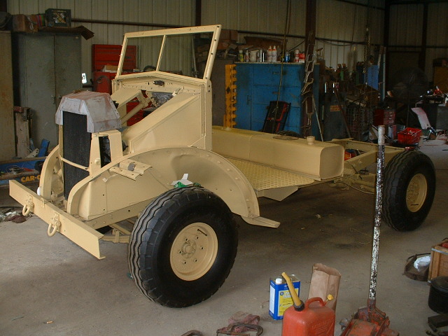

Hotter than Hell here in Texas, but in spite of it actually made good visual progress on the truck this weekend. Only advantage to the heat is my paint dries very fast!
Pulled the truck out of it's corner of the shop for the first time in months. It's actually starting to look like a vehicle again instead of just a very interesting pile of parts.
Cut and prepared new wood strips for the floor plates and primed, painted and installed the floor plates for good. Had to trim the large floor plate to accomodate the new SM420 transmission, but removed much less material than I had expected.
One thing I am noticing is as I install more cab components, the room for the driver is going away fast! Also installed glass in the windshield frame, but can't install the frame for good as roof components have to be put on the outer windshield frame first. Next weekend for that...
