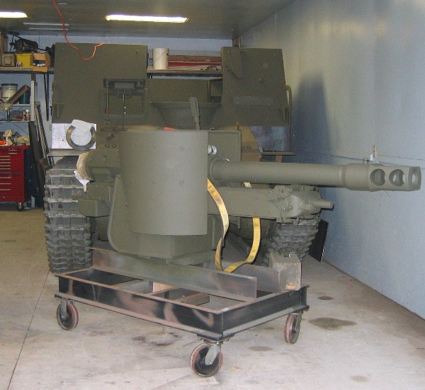

Gun tube repaired and muzzle brake fabricated

Back in gun mount, sand blasted and painted

One more photo, its starting to look the part.

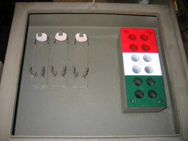

Somewhere in Europe there is a company that sells applique panels that a person can put on their home car garage doors. They are pictures of sports cars, tow trucks, power boats, fast jets, and countryside scenes, etc. Here we have THE REAL THING hiding quietly (or not so quietly) behind closed doors.

Perry; Super, detailed work. You were probably right about that cylinder, but go ahead and send it anyway, let them say for sure. How did you determine the colors of the flare holder? All I had left were a few scraps of rotten wood. Jesse.

Jesse, the flare cartridge holder is the original one. It was in remarkably good condition, their was still significant amounts of paint left on it. I just refinished it and bolted it back in. I am thinking of sending a couple extra barrels to Tulsa and they can pick the best 9. Did you have to replace valve guides or seats in any of your cylinders?
