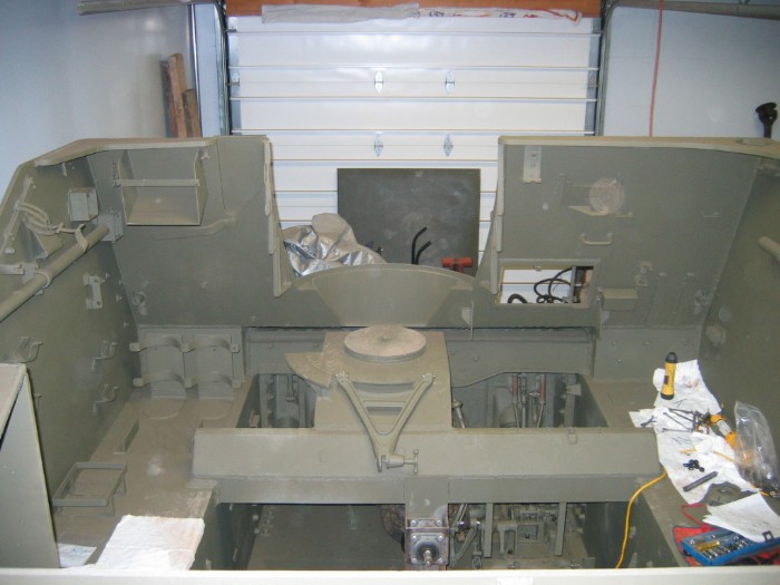

Old 25-05-10, 17:25
metal urgest
Join Date: Sep 2008
Location: London, Ont
Posts: 465
A belated update. Working on the engine now. Just a few small items to finish on the hull.
Sexton restoration 006.jpg   Sexton restoration 014.jpg   Sexton restoration 009.jpg   Sexton restoration 015.jpg   sexton retoration 2 001.jpg

Old 26-05-10, 03:10

Old 26-05-10, 05:05
Join Date: Sep 2009
Location: Waterloo
Posts: 366
Perry; Super, detailed work. You were probably right about that cylinder, but go ahead and send it anyway, let them say for sure. How did you determine the colors of the flare holder? All I had left were a few scraps of rotten wood. Jesse.

Old 26-05-10, 14:56
metal urgest
Join Date: Sep 2008
Posts: 465
Jesse, the flare cartridge holder is the original one. It was in remarkably good condition, their was still significant amounts of paint left on it. I just refinished it and bolted it back in. I am thinking of sending a couple extra barrels to Tulsa and they can pick the best 9. Did you have to replace valve guides or seats in any of your cylinders?
