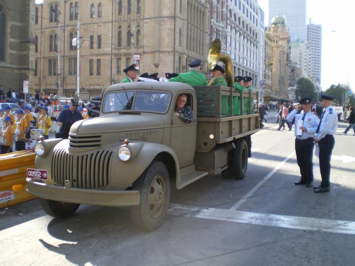

Test photo. Brass band on board ANZAC Day 2008. Photo taken at intersection of Flinders and Swanston Streets, Melbourne, April 25th 2008 whilst waiting to move off. My 90 year old father Ray, a WW2 veteran, in the passenger seat.
  #79
Old 13-06-10, 07:42
Default Test worked!
Nice image David.
What did your dad do during the war?
