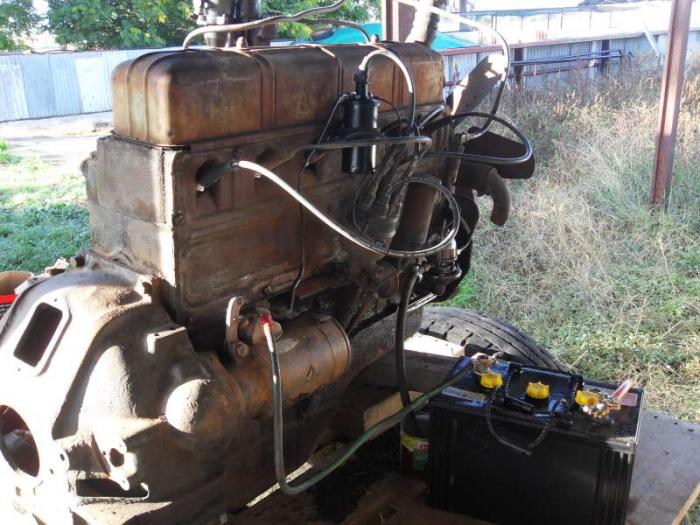

Ok
Brother! Have had steeeep learning curve with this truck but I have loved every minute of it.
So what have we done since last time? Rebuilt the Carter Carbie thanks Greame for your help with this. Put some new points in the Dizzy (From Repco at $14).
Got a set of Leads and 6 V coil and Battery. Put some fresh oil in her, overhauled the feul pump and tried to start her. Horrible backfiring!!
Checked everything.... Yep! all OK. Put No1 piston at TDC and took off dizzy cap......timing 180 degrees out. Pulled out distributer and refitted.
VVROOOOOOM!!!! All RIGHT!!!!
180 degrees out, move all leads 3 places around cap
Robert Pearce.

This leads me on to another mystery. The 30 cwt version of these trucks with the 9' tray used a heavier front axle and I mean heavier in every way including king pins and wheel bearings. Bearings are barrel rollers instead of the bicycle type cup and cones on the larger/heavier truck. It appears to be the same axle as under the 4x2 Blitz but narrower in the track.Figure that one out.
Righto David and others. I need some of the vastly knowledgable Chevy fellahs to help me with this.
Here is a picture of the axle that was originally under this MCP Chev. It is set up for the 18 inch military wheels and as David has mentioned above, has all the things he has described.
The brake set up as you can see is a more military set up with the shoe adjustments on the outside of the drum. Different to the set up of the civilian Chevy brakes.
The Slave Cylinders are Wagner Lockheed. Part no's Front FD613 (1 3/8") Rear 5300892 (1 1/2") Anyone familiar with these??
The shoes have no identification other than a part no 3822 R44, and a date on each shoe 5-2-41. The date would seem to provide strong evidence to confirm this was the orginal set up from the factory. One very wise brake guy told me Dodges of the era used the same set up.
Apart from the obvious reasons for posting to expand mine & hopefully others knowledge. I need one pair of these shoes. THE BLOODY COCKY who owned this years ago has removed one set of shoes from one side.
Can anyone shed light on where I might get a set??? Or does someone have some they might sell??
Im getting very desperate as not having these will stuff the whole project.
Calling on the MLU community to come through once again.

The search for brake shoes continues.....
After talking to the keepers of the Chevrolet Flame down at Corowa this year. It seems the common phrasing for these brake shoes in Chevy land is 'Cast Shoes' they are also out of what is known as a 'Timken Axle'.
A further piece to the puzzle was found at Max's at Yass in a Manual.
In the second picture it reveals that only the 1 1/2 ton trucks (or 30 CWT) had this heavy duty axle. Seems to confirm what we thought - that the truck is indeed a 30cwt truck.
The thrid picture decisively shows what these front brake shoes look like. Certainly not conventional Chev, but exactly what is on the front of this truck.
The long and short of it is Im stoked to have found out it is all authentic Chev in the rarer body wieght.....but we are still no closer to finding a pair of brake shoes for it.
Has anyone got any ???? Please??
