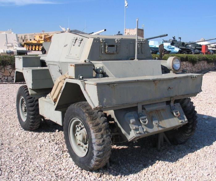

G'day All,
Just thought I would add a photo of what one looked like. I did not know so went hunting -
http://upload.wikimedia.org/wikipedi...I-latrun-2.jpg
