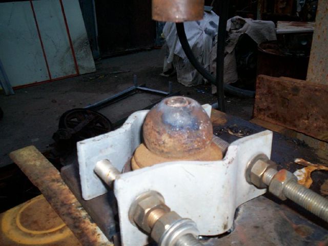

Second style of clamp plate for press. Didn't have a bought bearing clamp so made one to suit. Edit: Mk2 was unsuccessful at freeing the balls and he thinks that's because they were the lower ones and had rusted together worse than the top ball/cones. This Mk2 plate was in Bruce's opionion far superior to the original as it prevented the spring from being a factor where the Mk1 clamp gripped the outer sping and caused the ball and rod to lean in the press.

Rest of pics. Unfortunately this plate didn't result in a ball being released so Dad made the decision to cut the rod and mount each end stub in the lathe and drill out most of the rod before driving the remains out to free up the balls.
