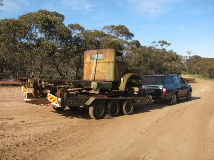

Well I'm home from South Australia with my new project.
It is a 1940 Ford Cab 11. 134"wb. with Chev Diffs.
The Bart Vanderveen Observer's Fighting Vehicle Directory (World War II) states"Very early Ford 30-cwt 4X4 trucks were designated F30S. the 'S' indicating short wheelbase, it was later omitted since there was no long-wheelbase version of this model. these early production models had GM banjo-type axles."
Now, the question is, What type of body was fitted to the F30S? What is available now?
The engine turns over and the drive line all works. Not too much rust in the cab. Missing is the drivers seat, and dog-house covers. Also missing are the 16" wheels. It came with 3 20" wheels only. Passenger door handle is also wrong. There is no ID plate, I think that it was attached to the missing dog-box panels.
So, just how rare is this one? Can't be too many out there nowdays.
Regards Rick.

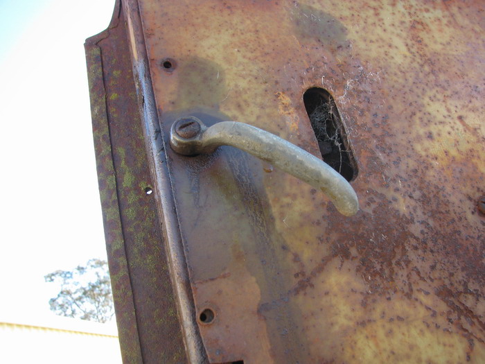

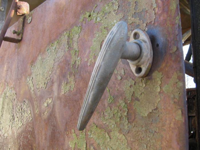

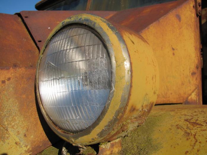

Old 09-07-10, 06:10
Interesting that it has a glass rear window. Looks like it has been there since new.
The left headlight rim was nickel or chrome at some stage.
The right door handles are good but the left door is of a Cab12.
The battery holder lugs are both still there as well.

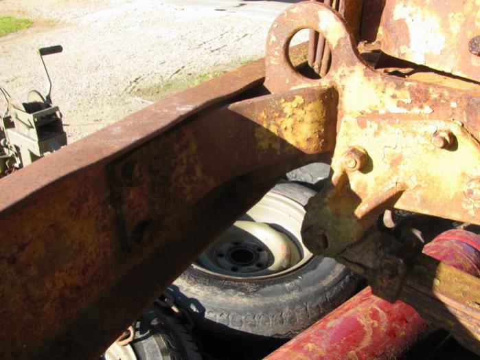

Old 09-07-10, 06:38
A close-up of the lifting recovery rings attached to the chassis.
The spring bump stops are not too bad either.
The muffler looks a bit second-hand but at least it's the right sort, size and shape for reference.
Rick

Old 09-07-10, 12:33
Default Towing eyes
I have one of those which came from a cab 12 chassis.
It looks like you have a two speed transfer case - are you sure it isn't a F60S rather than a F30 (there was no "S" used with the 30cwt version)

Originally Posted by Max Hedges View Post
...on cab 12s the louvers are a seperate piece that is bolted on and also ford doors didn't have a liner on the inside like the chev ones from what I have found...Max
Max, my remaining door on the old F15 has an internal skin. It may have been retro-fitted at some stage, however paint remnants match the rest of the body.(???)

Howard after further research cab 11 fords did have an iner skin on their doors
Max
Old 13-07-10, 15:01
Max, I'm glad about that as my right hand door has its inner skin and original handles and the left has the holes where the inner skin was screwed on.
Rick.
