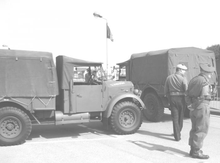

Can anyone identify these trucks? I thought they were 1939 Bedford's but the grill has too many vertical bars, no radiator cap on the bonnet and the side vents look too short. The film is of the BEF entering Belgium May 1940.

I'll have a stab.
Austin K3?
Maybe civilian pattern, going by wheels and lack of nudge bar.

Old 04-07-10, 08:21
I thought Austin as well looking at the grill
Old 04-07-10, 12:25
This is an impressed Austin K3, a 1939 civilian model. The later ones built for military use had a simpler grill with wire mesh.

Default BEF lorry
on 100% civilian Austin K3

Default K2 or K3?
Thanks for the good identifications. I did a search on K3 & K2 and found this photo that has the same exact grill, 4 short side vents and single drivers only wiper. It is supposed to be a K2.
Is there any good web page or book I can buy on these trucks? I'd like to model this and know little about the Austin trucks. The BEF used all sorts of civilian type transports and makes an interesting lot to model.

Default I forgot to mention....
The lorry has double type sandwiched wheels in the back and similar to those 1939 Bedford O class. It also looks like a long wheel base but I'm not sure which models were offered by Austin in the late 30's.

Default K3?
Birmingham Bedford, i.e. Austin! I have the Longbridge production figures so I'll see what they were offering in 1939.

Old 04-07-10, 23:48
Hi Bob,
Austin started truck prduction of K series in 1939. The vehicle in question would be a K4, it is a civilian model that has been impressed ( census number on cab door shows this).
K4 was not a model used by the military, but was used by Auxilliary Fire Service, Civil Defence, etc and essential users. K4 was rated as a 5 ton payload.

Hi Bob,
Richard I also think it is a K4 but there is an outside chance it could be a K3.
I saw the attached with a display board saying it was a 1939 K3 impossible I said; Its a K4 Mnnn how wrong I was The reg is Jan 1940. I also attach its chassis number plate;

Hi Ted,
Well thanks for that. It is the first time I have seen one of the NFS /CD vehicles plated as a K3, will now take a closer look at others when I come across them.

Richard I spent about 3 years visiting various archives re pre 1941 AFS, NFS and CD vehicles.. I established the Heavy Pump Units were K2 long wheelbase , the Auxiliary Towing Units were K2 short wheelbase, The 60 Foot hand operated Turntables were K4 as were the dropsides converted to Mobile Dam Units. The Civil Defence Column Rescue Tenders were on the militarised K3. In all cases I found period records which enabled me to match Registrations to chassis numbers. So you could imagine how the wind was taken out of my sails by this one; I eventually found a couple more of FYY reg where the owners said they were K3 The penny then dropped FYY 288 is not a Heavy Pump Unit it originally carried a much less common Extra Heavy Unit and has an extra locker per side compared to the K2 mounted Heavy Pump Unit. A Heavy Pump Unit has 4 outlets on the pump whereas the Extra Heavy has 6; I then found that the unit mounted on FYY 288 in preservation is actually a substitute as it was originally obtained from scrap minus a pump unit.

Default This is it
Guys,
Thanks for all of the feedback, some great responses. I found this K4 dropside photos on the net, a left and right side and it is nearly identical to the May 1940 BEF lorry which has only a single wiper arm, planks to build up the bed sides plus addition of a tilt frame, other than those modifications the restored dropside is identical.
I'm a bit confused as to what the changes are from K3 to K4 as the cabs I've seen at times are very similar.

Default Wheelnuts
We have been told at VINTAGE ROADSCENE that the number of wheelnuts changes between K2 and K4 models...the latter have more?
David the K2 had 6 the K4 had 8 what muddies the water is the civvy K3 also has 8 ???
