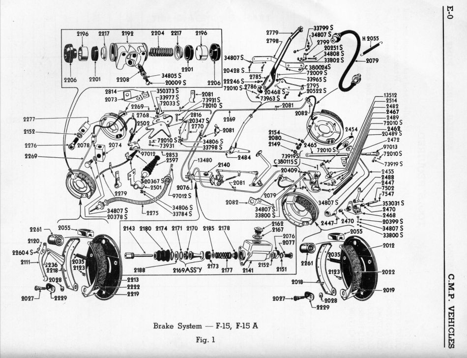

First I had a close look at the maintenance manual and spare parts list:
“Old location” (fig. 1):
Rear: metal brake line (p/n 91A-2269) running from master brake cylinder (p/n 91T-2140) to rear of chassis, flexible hose (p/n *C01Q-2078) from chassis to rear axle, metal brake lines (p/n 91A-2269) run from connector (p/n 01T-2074-A) to rear wheel brake cylinders (p/n (C) 91T-2261). Note the flexible hose is fitted to chassis bracket (p/n 01T-2073) with the use of a clip (p/n 78-2814-A).
Front: metal brake lines (p/n 91A-2269) running from master brake cylinder (p/n 91T-2140) along left and right frame channels above front axle, flexible hose (p/n *C01Q-2079) from chassis to front wheel brake cylinders (p/n C91T-2261).
I suspect this setup was taken over from the 2-wheel drive F15 to the 4-wheel drive F15A, and later relocated to the setup described below as it better suits a front drive axle.

Old 26-09-10, 14:53
“New location” (fig. 2):
Rear: metal brake line (p/n *C011QF-2265, length 87-13/16”) running from master brake cylinder to rear of chassis, flexible hose (p/n *C01Q-2078) from chassis to rear axle, metal brake lines (right: p/n *C01Q-2267, length 46-7/16”; left: -2268, length 19-11/16”) run from connector (p/n 01T-2074-A) to rear wheel brake cylinders. Note the flexible hose is fitted to chassis bracket (p/n 01T-2073) with the use of a clip (p/n 78-2814-A).
Front: metal brake line (p/n 2234) running from master brake cylinder to front of chassis above front axle, flexible hose (p/n *C01Q-2079) from chassis to front axle, metal brake lines (right: p/n *C01QF-2263, length 54-3/8”; left: -2264, length 73-1/2”) run from connector to axle bracket (p/n *C11QF-2083). Flexible brake hose (p/n *C011D-2079-A, length 12-1/4”) connects to wheel brake cylinders. Note the flexible hose is fitted to axle bracket with the use of a clip (p/n 2814).
