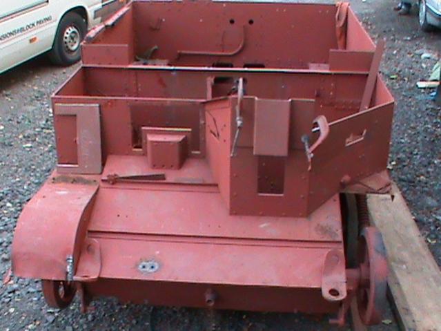

Hi
My name is Paul Butler and I am a new member of your Forum.
I am currently restoring a Canadian Carrier Serial Number TL230F date of manufacture March 1941.
The carrier has the remains of some markings on the front, one of which I have been unable to identify. I attach some photos to help.
The marking in question is the 159 in white backed with green and blue. As far as I can tell it refers to a Reconnaissance Regiment and the white bar beneath suggests an HQ or command vehicle.
Can anyone help me please?
Many thanks
Paul

Hi there Paul, welcome to the family, the serial number you quoted, where was it located ? the lower hull number should be located on the passenger side of the vehicle on the rear end...its on the angle bar that holds the rear armour in place over the nearside track guard.
you have joined a great group of people with a wealth of knowlege.....looks like with your carrier we must have just about a full carrier platoon in the UK now guys.
can you tell us a bit about how you came to find this particular carrier ?

TL230 F sounds like a part number. Where exactly is the number on the carrier? Can you post pictures of the inside, and inside rear?
And yes welcome aboard! This is a terminal disease and you have just entered a rehab program. ( you are now titled "Registered user" as are most of us here)

The serial number quoted is that on the brass plate on the O/S front track guard. I attach a photo, quality not good I'm afraid , I will try again in due course. Also attached some further pictures of the carrier. As yet I have found no serial number on the hull.
I don't have much history on it except I bought it 4 years ago from a collector local to me. He in turn had imported it from one of the Scandinavian countries where it had been used by a logging company to tow away cut down trees.

Your green/blue "159" suggests a regiment in your own 79th Armoured Division. I don't know which one, but I CAN tell you 1CACR were "157" and the British "APCR" were "158". One of us here will no doubt be able to enlighten you further, but I'm pretty sure this was a Canadian carrier in British service (not uncommon).

In regards to the serial '159' on the Arm of Service marking you are asking about, is it possible that the serial (or number) on this marking is '459'?

Mark you could be right about this. I had another good look over the weekend and the 1 could in fact be a 4. With quite a bit of the paint missing it is difficult to 100% sure but it would mean a vehicle from 32nd Reconnaissance Regiment the Royal Montreal Regiment. There are the remains of the First Canadian Army marking on the front plate also, I attach a photo.
Richie I also found the hull number on the back where you said it would be. The number is 457.

wow that is a low number...so potentially very early in the mass production side of things...we really need Nigel here on this one, i have never seen a serial number start like a part number... as Lynn says most components on the carrier start with a TL or CTL... and i have not yet seen a serial finish with a letter mind this means nothing....just means i have not yet seen it.... do you have any images of the rear plate (where the diff bolts to)
and perhaps some pics of the pedals may assist us (but not difinitive) i am going to chuck a guess in there and say that the pedals will be the ribbed pattern rather than the diamond plate.. you can all laugh at me if i am wrong ....its highly possible

Here are some further pics. The ones of the rear panel probably won't help much but they are all I have for the moment. I will try and post some more later in the week. I reckon the carrier is quite early as so far I have found very little dated later than Feb 41.

things move fast in the carrier network, it looks like the rear armour panel is missing from yours i have a spare one you can have, it's a little bent but very useable and your welcome to it, i'm also getting a new speedo cable made for £30 do you want one . i would assume you have the same dash panel as mine with english instruments with the smiths speedo. give me a call on 07970828122 if you need anything
all the best

I figured that it was ‘459' and not ‘159'. The attached are an example of the markings used by the 32nd Reconnaissance Regiment (Royal Montreal Regiment), C.A.C. from approximately 25 January 1943 to 12 April 1944. On the left, the AoS marking with serial '459' and white bar below to denote 'Army Troops' and on the right, the Formation sign used by 'First Canadian Army Troops'.

Unless Paul found another Arm of Service marking painted over that of the ‘459' serial, it is highly unlikely that the carrier was used in ‘action’. The 32nd Reconnaissance Regiment (Royal Montreal Regiment), C.A.C. was converted and re-designated the First Army Headquarters Defence Company (Royal Montreal Regiment) and reallocated to the Canadian Infantry Corps from the Canadian Armoured Corps effective 12 April 1944, whereupon they would have adopted the AoS marking of serial ‘9' on a black background with a 2-inch white bar beneath denoting ‘Army Troops’.

Originally Posted by Mark W. Tonner View Post
Hi Paul;
Mark , thanks for your input on this. I am going to do a little research on the 32nd and see what turns up.
regards
Paul
