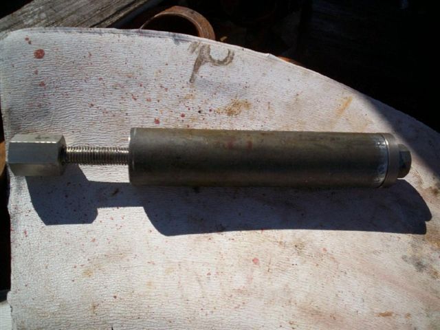

Default Bogie compression tool
Here's the compression tool Bruce made based on the pics others provided in this thread (Thanks!)
