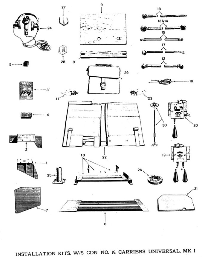

Does someone have an actual list of what a working WS 19 set would comprise in a MK 2 carrier canadian?By that I mean what are the proper junction boxes,cable layout call boxes headphones and hand mic"s etc.I would like to get a working set for my MK 2, but am unsure about what the proper bits to grab.Ther's bits here and there on evilbay. But no point buying the wrong stuff.Thanks for any info.
Old 09-12-10, 11:28
RichardT10829's Avatar
Richard Harrison
Join Date: Nov 2008
Posts: 3,071
Hi buddy the full list and positions of boxes etc are all in the UC-F1 service book if you have it ?
is mos redintegro
__5th Div___46th Div__
Lower Hull No. 10131
War Department CT54508 (SOLD)
Old 09-12-10, 11:48
lssah2025's Avatar
Driver Advance!
Posts: 487
WS 19 installation

Lance. incidentally as much of this as possible is what i need for my carrier buddy

Old 09-12-10, 15:59
Posts: 4,192
Thos diagrams are for the Mk1* Carrier. The Mk2 will be different for some stuff. As to what, Im not sure.

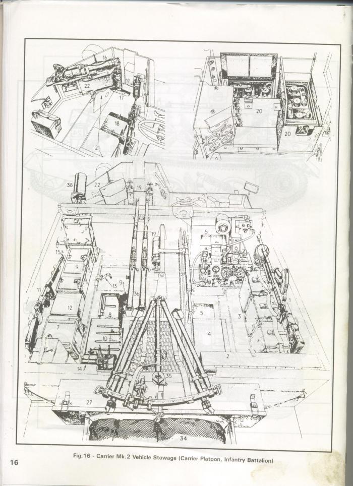

the Mk2 had the unit fitted behind the drivers side air ducting across the hull rather than on the track guard ala Mk1... other than that i dont know

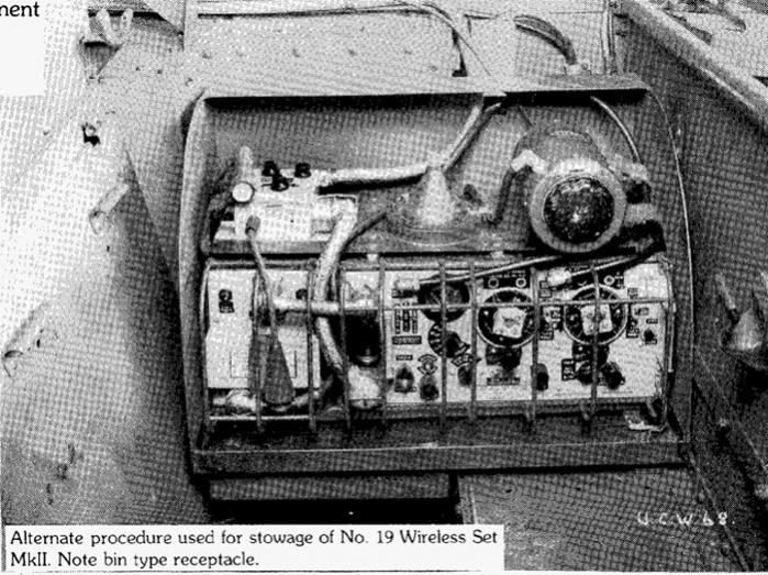

Old 09-12-10, 20:03
This is the setup in a MK 2.
Old 09-12-10, 20:17
horsa's Avatar
horsa horsa is offline
David Gordon
Location: Lorena, Texas, USA
Posts: 619
Default Another UC Mark II Installation Diagram
No specifics on the W/T No 19 with the drawing to show any of the specifics unfortunately.
