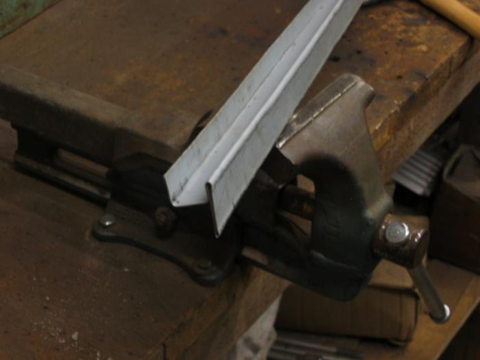

here are some more pictures of the vent openings on the roof, they are in place now only need some paint when it is not so cold.
after this I started to make new windowframes because the old ones where not there so after some long thought I came up with a plan to make them.
first i cut 10 strips of sheetmetal 4 inch wide and 1 meter long. I have to do 3 windows. they have to be bend in a "h" shape so, step 1: I bend the long side of the h
dubble for a strong part of the frame. because the screws are going through this part. step 2: now you can bend the "U" part of the frame where the glass comes in. to stay on the right size I used a square piece of pipe in the right size to hammer the sheet metal around.
I used some hardwood parts to klemp the sheetmetal in between so the bends are getting right and not bumpy.
it takes a lot of time to make but if you can't buy you have to make it your self. in this frame I put a rubberseal and the glass fits in this rubberseal.
(see the pictures in the next thread to)
cheers jaap
vent unit 17.jpg   vent unit 18.jpg   raamframe.jpg   raamframe 2.jpg   raamframe 3.jpg

here are some more pictures of the windowframes and the tools I used.
cheers jaap
raamframe 4.jpg   raamframe 5.jpg   raamframe 7.jpg   raamframe 8.jpg   raamframe 9.jpg

Now the wood work is in I could put the charging panel on it's place.
As you can see I am missing the switches so if anyone has some I like to know.
the panel go's under the radiotable so the operator can selekt the right possition with the switches.
I had to do the last side panel door for the generator box. So I cut the hole in the righthand side and hammerd the edges in to there form.
then I made the wooddoor witch is to be coverd with sheet metal same as the other one I made for the back.
but that next time.
cheers jaap
oplaat paneel.jpg   oplaat paneel 2.jpg   oplaat paneel 3.jpg   body  51.jpg   body  52.jpg
