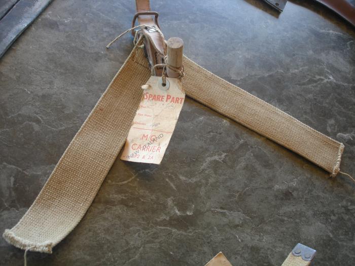

Straps. When you say there are only five, i take it that you mean that the others are canvas, because there are more than 5 straps.
You raise more questions than you answer.
TL12633 comes in two lengths. The stores replacement (shorter, and thicker) it may not fit.
I have some that need to be identified. Can you help?
Pics 1 and 2 are the same strap
Pics 4 and 5 are a quick release arrangement. Is it in fact U.C.?
for Jordan 001.jpg   for Jordan 002.jpg   for Jordan 004.jpg   for Jordan 005.jpg   for Jordan 006.jpg

From your first posting, pic 4 & 5 are for the tow chain. Ive only ever seen it in canvas.
C01UC 100842 is the canvas shovel strap. This would have replaced the rubber one (TL 12633 and CTL 12633)
C01UC 100841 is the canvas strap for the Boys barrel support brkt. Not too sure how they fit on the bracket but thats what the parts list shows.
TL7321 is in fact the strap for the tow chain. The parts listing then says to use CTL7321. The strap I have is the same from your pic 4/5 from above. I wonder if although they share the same part # they were trully made differently as shown from your pictures.
TL13822 I have no idea as its not in the parts listing
TL12608 Jack strap, can you give the dimensions for it please. Also is the end with holes have part of it missing? Would they have a hole that close to the edge?
TL13200 Never seen white straps before?
TL12633 Shovel/pick axe/crow bar. Just to confirm. You have 2 different lengths? Long is L 270mm, W 25.4mm, T 3.6mm Short is L 215mm, W 25.4, T 4.8mm

I'd say the white strap is natural rubber. yes the jack strap could be missing the end. I dont know why they have a choice of holes because in practice some would not reach.
TL12633 yes I have new ones, which I dont think will fit through the holes in the steel brackets. The long thin one is original. and if I was making them I would go with the original.
So what do you make of TL13801?
