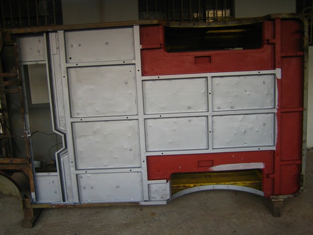

Default Rear door scratch build.
One problem that from the begining seemed to me like a nightmare was the total absence of the rear door.
Allen Tooes from the South Hampshire UK, -friend of me now! -send me a HUP rear door, but it was so rusty so I used it as a pattern to make a new one.
I think the final result is very satisfying.

One problem that from the begining seemed to me like a nightmare was the total absence of the rear door. Allen Tooes from the South Hampshire UK, -friend of me now! -send me a HUP rear door, but it was so rusty so I used it as a pattern to make a new one. I think the final result is very satisfying. kostas
Satisfying indeed. Excellent work. Did you make a construction diagram for the door?
Νο Rob, we just dismantle the rusty door Allen send to me, we extracted the lock-door assembly and we made a copy of the hole thing inch by inch. We transplant also the hinges.
At the last photo Giannis measures the distances from each side, was 42 cm, or 16,53 inches.

A little update on the works:
Before and after:
ID:	47248Click image for larger version
ID:	47249Click image for larger version
ID:	47250Click image for larger version
More pics to come tomorrow!
Today is Balentine's Day, and my wife is gonna kill me if I stay longer above the PC pad!
1940 BSA M20
