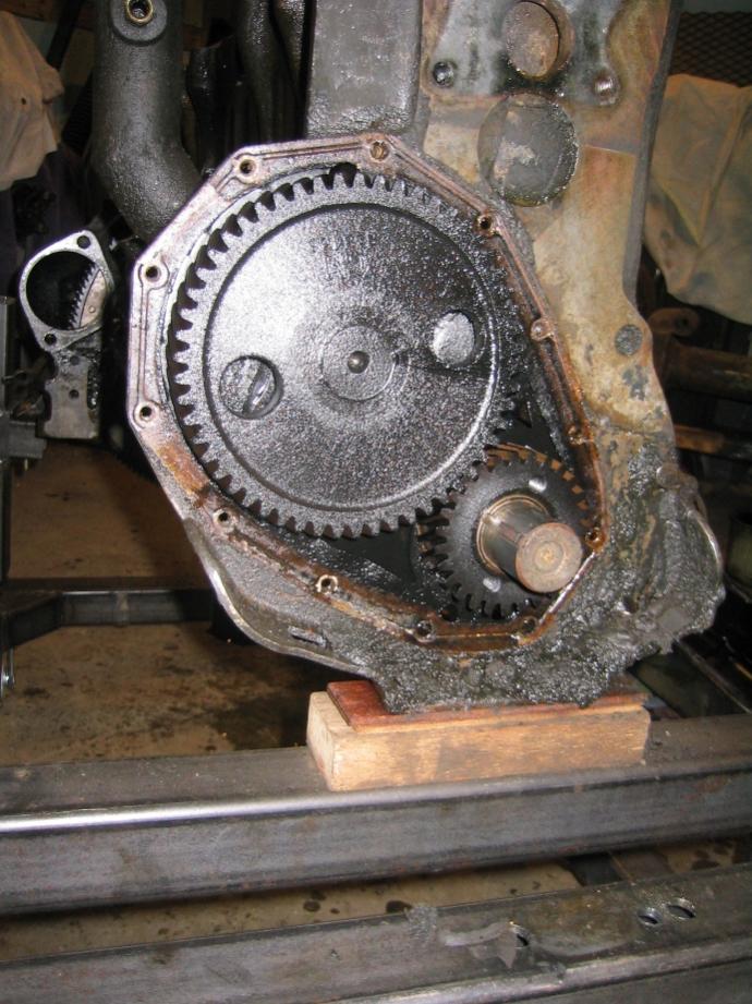

Default Whats wrong with this picture?
Take a look at the picture first, see if you can spot the problem? Got the problem? Well here is a hint note the assembly aid the white arrow and letter. also note the position of the hole for the lub fill.
Got the problem, one last hint the top edge of the picture is the top end of the transfer case and the mounting bolts.
Yup, the cover will actually bolt up the wrong way around and all the bolts lined up as did the locating pins.
It only took me three tries get all three gear assemblies back in and shimmed correctly.
Turned out that the only real work that need to be done on the transfer case was replacement of the seals. There was no dirt or any sign of wear to any of the gears or bearings.

Old 17-04-11, 19:24
Default Detergent or Non-Detergent that is the question
Detergent or Non-Detergent Oil that is the question? Well from looks of this engine it is hard to say, this engine has been running straight 30 weight non-detergent oil for 66 years, without the sludge buildup that all the oil commercials say should be there. As mentioned before as far as I know this engine has never been fully apart in all that time. Of course given the amount of oil leakage that has developed over the last few years maybe all the sludge has been leaking out.
But I don’t think so I suspect that the true answer is that if you change to oil regularly and drain the oil when it is actually hot that there is very little left behind. The only place with anything you might call sludge or deposits was on the inside of the front valve train cover, which has some light crusting which may be the result of this likely being the coolest area of the engine.
The large military style filter probably is also responsible for keeping the oil clean. On Beauty my Pat 13 C60S which had the oil filter mounted hidden in the frame rail the filter had sludge but the engine was clear of sludge. On that engine I suspect that the oil got changed but the filter didn’t.
Before disassembling the engine I did some testing of how long it took for the engine to actually reach a uniform temperature, where water temp, bottom of the oil pan, oil filter and the oil pan above the level of the oil all reach the same temperature, as you can see at no load it takes a long time to get the engine fully up to temperature.
Oil Temp to time.jpg   Web 4-16 Beast Rebuild Camera 019.jpg   Web 4-16 Beast Rebuild Camera 009.jpg   Web 4-16 Beast Rebuild Camera 013.jpg   Web 4-16 Beast Rebuild Camera 011.jpg
Old 17-04-11, 19:36
Default Detergent or Non-Detergent that is the question 2
In the Oil Pressure to Time chart you will note that only part way through did I discover that the oil pan had two very distinct temperatures Lower Pan which was the very bottom while what is labeled OilTemp pan was actually the side of the pan above the level of the oil. Also not how much of a temp difference there is in the radiator from top inlet to lower outlet basically a 100 degree difference. (see chart above)
Here are the photos of the valve gear train and cover.

My experience with sludge in engines was far more spectacular. Sludge to me is a light greyish ash like residue that you could scrape off with a putty knife..... maybe the cold weather here made it worst..... but no amount of detergent oil could ever remove it.
On a late 56-57 390 Ford engine..... we tried to cleanup the sludge inside the valve covers and removed the pan to scrap out deposits..... we literally flushed the engine.... in the frame... with gasoline to remove all the sludge
... installed new gaskets on the pan and valve cover.... engine never ran properly again.... was ticking and slapping like crazy and smoked like crazy..... I think the sludge actually was keeping the engine from leaking so much......
Your engine in comparison is very clean for 65 years of straight weight oil.
