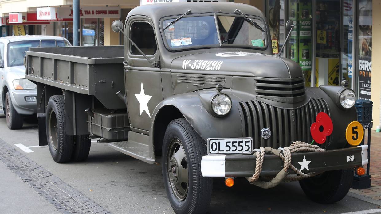

Is this a model E11 or E10 ?
  #58
Old 03-12-20, 03:44
Posts: 6,039
Default E11
E11 has the seperate cab / tub as in your pic.The E10 has the coupe style cab , one piece, the AIF seemed to have the E11 type mainly
I think that the photo is still a model E 10. The cab, separate from the body ( light truck ).
