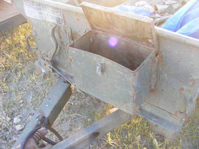

I am seeking info on the "document" (?) box mounted on the front of M-100 trailers.
Mine doesnt have this box.. are there any for sale? if not, could anyone supply info on dimensions, mounting etc (or could it be these were a type of standard ammo box??
also looking for the light switch mounted on lower front
thanks
monty

The box you are speaking of is likely the box that held the 24V cable when not attached to the towing vehicle. The M100 I used to have had the box, but it wasn't at all like an ammo box - IIRC it was about 10 inches wide, 5 or 6 inches from front to back and 12 or so inches deep, with a hinged lid. I would be surprised if you couldn't find one for sale online somewhere.

The boxes were redundant on the MCI Cdn M100s, since the inter-vehicle cable on the Cdn trailers were attached to the chassis wiring, as opposed to the removable one the US used. The US version had two similar plugs on each end, along with a receptacle on the trailer similar to the receptacle on the towing vehicle. When not in use the cable was stowed in the box mounted on the front of the trailer. As Hanno pointed out, these are available from John at midwest military, although you will hav to make up the two mounting brackets if they have been removed from the cargo box.
We would remove the boxes when they got damaged, or if there was a need for a similar size box somewhere in the shop. Quite often they would end up on the oxy-acet welding carts to hold the extra tips.
There was also a document box mounted on the inside of the trailer. This was almost identical to the document box mounted on the early M101 3/4 ton trailer, or the 1-1/2 ton trailers. As far as I know this document box was purely a Cdn item, and not available as a repro, but I could be wrong.

Marc, I can Take a photo of mine tomorrow when i get back to work if you are still looking for one, they are not much bigger that the side of a tm book as has been stated.

Thanks jason, but mine has the slot-like box inside the trailer...unless there was a lid for this? (which mine doesn't have...although it doesn't look like there was a lid.
however if yours has the bigger box on the front, some nice photos of that would be apreciated..esp the way its mounted, as these boxes can be purchased
(thanks againi for the link guys !)
BTW do the catches on those boxes have a hole to be fitted with a small pad lock?

Yes, there is a lid for the pamphlet box. Note that it opens left to right. There were a pair of solid rivets which acted as the hinge IIRC.
There were no catches on the pamphlet holder and only one latch on the cable holder with no locking feature.

Marc, Here are a few photos of the m-100 also added the serial number that is stamped into the draw bar for comparison.
Jason

My camera showed up in the mail with my luggage from Kandahar today, so I shot a few photos of the M100 trailer cable stowage box, the M100 pamphlet box, and the pamphlet box mounted on the side of a M104 1-1/2 ton trailer box. Note the M104 box is held on with screws which make them a perfect candidate to supply the box for the M100. You could just fill in the holes with weld to attach it to the M100.
2009_1220newfiretruck0009.JPG   2009_1220newfiretruck0008.JPG   2009_1220newfiretruck0011.JPG
