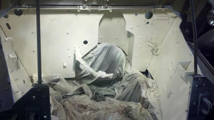

My 44 Humber Scout MK II, had white underneath but no silver, and judging by my frame number it was a Dec. 44 build date.

You bought your Humber Scout in Holland, did you not? IIRC, this was restored from a complete wreck with hardly (if any) paint left, similar to the one show below (picture linked from LWDparts.com). I think this one came from the same cache as yours.

It wasn't from the same cache, it was supposedly from a a different owner, those in the pic were originally owned by Clive, from the info that I have received and investigated over the last few years, but can I say that I am 100% positive, no I can't...
After restoring it for a second time I found a different layer of white (small patch), now was it from the original, who knows. Or was it a test batch of white from the museum when they restored it, who knows!!! I know the museums other car (without the roof) was restored at the same time and has the same color, mirrors etc as mine.
In my original pics that I have some appear silver and some white, the early cars appear silver and a few of the MK II's appear white. I wish I had a definitive time frame on what was painted what and when..
Look at Jack in the Box II (HSC MK I) F196345, it appears to have a white interior and went to the museum right after the war. Now I do not think it has been repainted on the inside, maybe someone at the museum can shed some light.

Well just finished spraying my interior, silver or white was my dilemna too, ended up going with white..just wanted to show some more of the restoration..

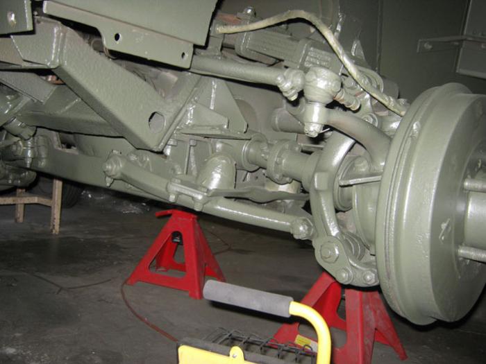

Default updated pics
Updated pics, using post war gauges until my original/correct ones are restored, also have the correct speedo to put in. Brand new wiring harness being completed, next the engine will go back in, then exterior paint and finish bolting in the internal bins etc...

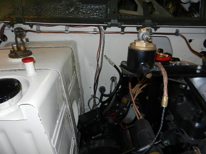

Humber update: pics here

Some more update pics...
