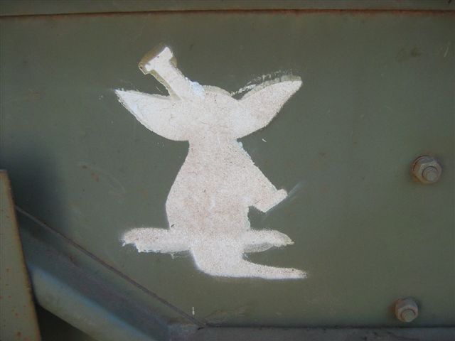

Pic 2 Tailgate art, "QA" ?, 50 ?

I like the Bilby idea, other than that I guess we can narrow it down to an animal with big ears, two feet and a tail. I must admit that this figure has really bugged me for the last 3 years, it had some longevity as it appears to have been painted on twice.
Rich.

Bilby sounds good, and the weapon is most likely an RBS70 VLLADS missile pod: it has the right look, and is with the right Regiment (16AD).

Thanks Diana, I think REMLR has come up with the goods on this one, A loaded Bilby it is.
Mike, Never heard of a RBS70 VLLADS missile pod, had a look on the web, if this is what you mean:

The image on the weblink you gave shows the missile pod sitting on top of the launcher cradle/aiming device/tripod. It's the tubular 'bit' at the top. Note the thicker ring around the end, and its the same at the other end, just like in the drawing of your 'loaded Bilby'. The missile pod is removable/replaceable on the launcher. Each time you fire it, you take off the empty tube, and clip on a new one.
I'd say with little doubt that that's what the drawing on your trailer is supposed to represent. Yep, a well armed little sucker: ask any RAAFie silly enough to fly 'nap of the earth' within range!

Hi all - the animal is a Platypus which is the unit animal for South Australia. Each state had their own animal and bilbys did not feature.

The Platypus.

Hi again - to me it looks like some sort of shaft or pin. It has a five sided bolt head with corresponding facets running along its length but starting under the bolt head. It doesn't look like any weapon to me.

Awful big ears Bob, and a thinner tail?

Have to agree with Richard and Dianna on this one, Bob. It's like no Platypus I've ever seen. But just as a test, I showed the image to my wildlife-artist wife, and asked 'what Australian animal do you think that might be?' and her immediate reaction was 'Bilby: only long-eared, long tailed Aussie animal it could be'.
As for the 'bolt', well, the trailer belonged to the Q-Troop (supply troop) of 16 Air Defence Regiment, who exercised regularly at Woomera and Cultana, so an RBS70 missile pod slung over the shoulder of whatever animal it is is appropriate, and the Bilby idea fits with their likely encounters with Bilby's in their training areas.
'Each State had their own animal and Bilbys did not feature'? I agree that the Bilby did not feature, but can't agree that the official Divisional Formation signs from WW2 bear any relationship to 'states' or are 'state based'.
Besides, as Dianna said, this is post war. We see a plethora of different emblems adopted by units: the pig for 5RAR, the Black Leopard for 1st Armd Regt (now a lion), the eagle by 2Cav, Scorpion by 3Cav (carried through to 3/4Cav) and the strutting rooster for 21 Construction Sqn, to name just a few (others).

Tail gate art "White rat with the red Eye shoulder launched missile behind" indicates that the trailer was used by the 111th Light Air Defence Bty, 16th Air Defence Regiment;

Never thought of the Redeye! That certainly dates the trailer: Redeye was in service for a relatively short time, and has been out of service for many years.

In my ignorance,(dont go there Bob) I'd never heard of one before this thread, so found a picture. This is the Greater Bilby (the lesser is extinct) They are about rabbit sized and highly endangered.

Thanks to all concerned with finalising the service history of this trailer. It shows the importance of finding all those old markings, although in this case they were clearly visible. I do now wonder what is hidden under these ones in the lower strata of paint....
I doubt I could ever bring myself to repaint it to match the Humber, too much history in it's own right.
