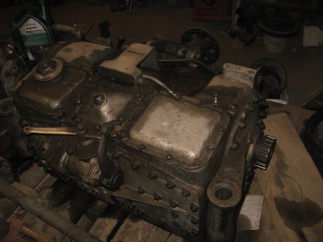

Old 03-11-11, 13:48
Matt McMahon
Location: Oberon NSW
Posts: 180
Please see below some side view details of the engines, stearing clutch and gearbox detail
Kind regards
Matt

Old 03-11-11, 14:18
George Moore's Avatar
George Moore George Moore is offline
Join Date: Jun 2011
Location: Plymouth UK
Posts: 131
Default Fantastic
Thanks guys, just what I needed.
I should have mentioned that I was needing photos of the engine and gearbox "out" of the tank, these are just what I need to show the shape of the block etc.
One query, the oil tank is mounted on the "outside" of each block, I see one of the photos has it mounted so it would be between the blocks, is this just to show things part assembled?
The later engines are listed as "improved Leylands", these seemingly had the oil tank attached, plus other additions such as oil cooler tubes running across the gearbox end of the blocks, improved filters etc.
Wasn't aware of the sumps though, thanks for all the info.
The manual for some reason has sectioned drawings of the AEC engine, which are useful, but strange in that the sump on the drawings is totally different to that fitted on the tank engines. The most obvious difference between the AEC and Leyland (there are others of course), but at first glance, the Leyland has a much wider and flatter rocker cover. I did not realise that the rocker cover came apart either, thanks for that.
If there are other photos, please send them on.
These really help, and thank you all very much.
I cannot get the link to work (?) but should you wish to see some of the model work I have done, look at www.mooresmilitarymodels.co.uk
Thanks again.
George.

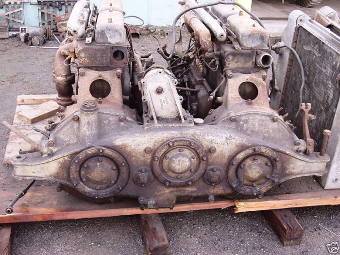

Old 18-11-11, 10:13
Matt McMahon
Posts: 180
Some photos of the AEC pack for comparison, in case you havent seen a real one.
Kind regards
Matt

Old 18-11-11, 11:18
Join Date: Jun 2011
Posts: 131
Default Aec
Thanks Matt,
I believe you had posted these before, which I admit to downloading, and started to prepare a set of scale (modelling drawings), coupled with a set of drawings from a modelling web-site.
Having researched the subject deeper, the available kits can be converted into the early or later Mk's of the tank, all that I had missing was the "shape" of the Leyland block, as your photo's showed the AEC profile exactly.
In conclusion, I now have two sets of drawings in progress, of both types.
The intention will be to make models in 1/35th scale, even though after all the effort, v/little of the engine will be seen once all the other gubbins are in place.
One more plea, if there are some other photos of the gearbox than those already sent, they too would be of great help.
I think I am correct in saying that the clutch end / drive casting for both types is similar ??
Thanks again guys, your help is of enormous value and having myself been involved in working on cars from my early days, I take my hat off to the work you do.
The enclosed: my first proper car, my latest project and a birthday present from my wife was a day out driving a selection of military vehicles, I could'nt get the Sultan in my garage anyway!!
Regards and thanks.
George.

Old 22-11-11, 08:40
Matt McMahon
Posts: 180
Hi
The cross drive is the same apart from the compressor drive on the aux drive.
The gearbox has 4 small legs although they dont touch the floor when mounted in the tank. The gerbox is a constant drive to both sides, they are made with two oil pumps, one is driven off the input shaft and the other is driven off one of the output shafts. (so oil is supplied when been towed).
Kind regards
Matt

Old 22-11-11, 14:01
Join Date: Jun 2011
Posts: 131
Default Excellent
Thanks for those Matt,
The overall drawings from the manual give the basic shape, but not all the lumps and bumps.
These are excellent and just what I need.
The info on the oil feed pumps is interesting, and something I would not have thought about.
The transfer case, yes I see from the drawings that the compressor housing changes between different Mk's.
Now I have something to work from, especially the way the engine block breaks down to a lower case, mid section and heads, it all makes sense now.
Thanks for all the info, and your time.
George.
