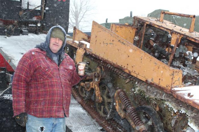

Well,
The roads were not great with the left lane of the 401 snow covered at Gananoque when I got on but by Prescott it cleared up a bit.
Arrived in Cornwall and the city streets were snow covered, it was minus 8 degrees c at this time and the wnd was blowing fairly hard.
Once at the unit the first challenge was to open the yard gate as the padlock was frozen so out with the small propane torch to thaw that out.
The officer in charge of the Armoury met me and we went to the back yard and he started an LSVW to get it out of the way.
While we were waiting for the tilt n load tow truck we used some straps and shackles and a rental forklift (awaiting pick up from a previous unit event) to gently lift the front of the carrier, resistance was futile and the vehicle lifted out of the ground bringing with it a great big lump of frozen ground under the tracks on both sides.
A few minutes later the tow truck arrived and moments after that James and his mate John arrived with a coffee for me! What fine service.
For Shaun in the UK we present a picture of the carrier in motion an myself in suitably gruby winter work wear!

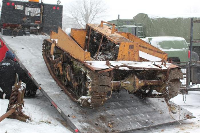

Robin Craig's Avatar
Posts: 2,164
The tracks did move and the vehicle did roll up to a point but then stopped, I think the extra frozen mud jammed the track under the shroud which is what happened.
Anyway the pulling continued and the carrier slid up the deck and we were at a point that the deck could be lowered. At this point I was thanking the good lord for not having to get down and dirty and split track in the cold, that was something I did not want to do.
Next we lined up our trailer and the tow truck to do the cross decking operation.

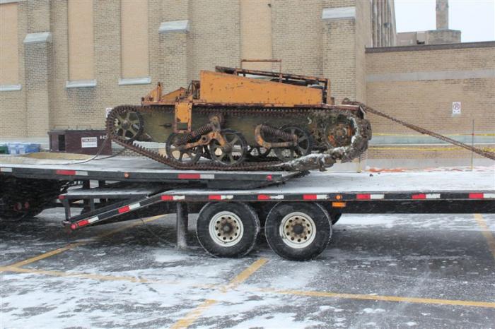

Posts: 2,164
We had two options as to how to cross deck, we could place a pulley block in the centre of our trailer secured by a chain and pass the winch cable underneath and back to the carrier but instead elected to slide the tow truck deck over our trailer as far as it would go and cross chain the carrier to our trailer and slide the deck forward out from underneath the carrier.
We did this slide operation twice at least and got the carrier onto the trailer, notice the clods of frozen ground which we would have to address.

Well,
