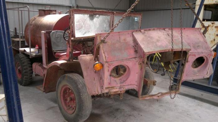

Gantry again to take the nose off and the rear water tank. It will not be going back on as there was a large amount of internal rust.

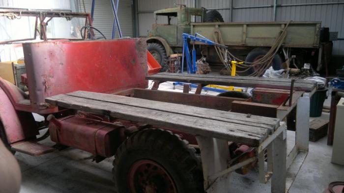

Next to come off was the old timber tray section and the Holden radiator.

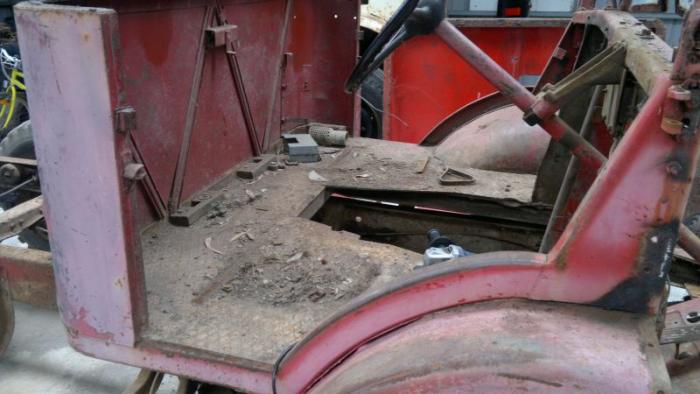

Got a little bit of shed time today after a busy weekend. Managed to remove the seats and found both in great condition. Snapped a couple of bolts removing them but that's no biggy.
Also removed the three main cabin floor bolts for the next time I get back to it.

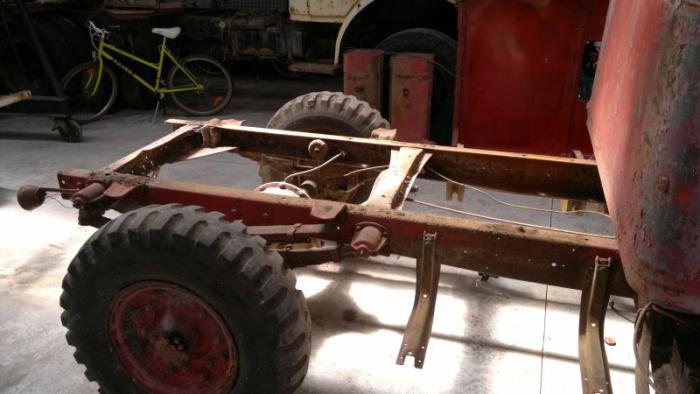

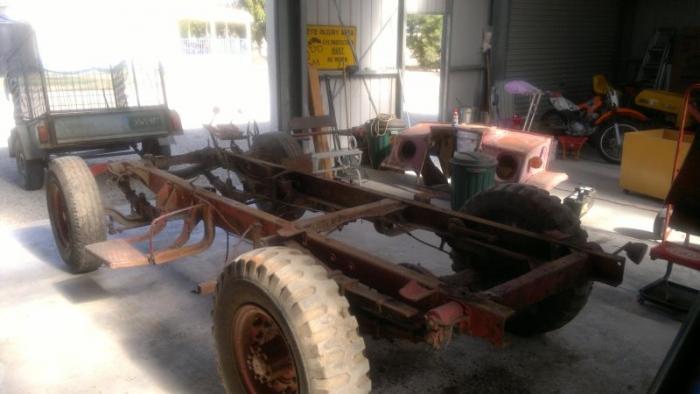

Default little step
Got into the shed this afternoon and removed the driveshaft, steering and the remaining cab freeing the chassis for a good look.
Of the 4 shocks only one is 100% complete and the original radiator mounts have been cut off during the conversion to a holden set up.
My questions are:
Can the radiator mounts found on the F60 chassis be used on a F15 chassis?
And can the shocker arms (not the housings) found on F60/C60 be used to replace the missing arms and connections on my F15 chassis?
Blitz books.

Default Chassis details
My questions are:
Hi Ryan
The radiator brackets are the same but I think the arms may be different on the shockers. They are shorter and have more of a crank in them.

Default shock arms
Thanks for that Keith, I do know of another F15 wreck that has them but its a bit of a hike. Better get my boots.
