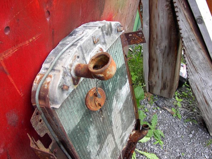

Old 05-01-12, 04:27
Posts: 5,267
Default Radiator goose neck for cab 11
Hi Bob
See the attached pic.....
On the cab 11 the special ..odd.... 90 degree goose neck is lead soldered onto the radiator tank...... never seen a loose one as a NOS one...... Biran Ashbury has the NOS radiator cap with chain.
You mayhave to buy a whole radiator to get that part. In most instances we wind up buying a delapidated radiator just to save the top and bottom tank.... and pay around $400 to have it recored with four rows of tubes.
It is usually easier to find a cab 13 rad (which won't fit )than a cab 11/12.... but don't give up yet....... not usre what I have at the barn....will need to look around..... and there may be some others on the forum with a rusted out rad that is willing to remove the neck for you.
HAng in there..
....ahum..... I think I have one from Mike's truck...... I know I have one with a piece of PCB pipe adaptation....will need to check what over all shape it is in..... stay tuned.

Default rad cap
your pics show me what mine is supposed to look like. all I need is the piece the cap turns into & the cap. it solders into the elbow on the gooseneck.

Now to Bob...
How bad or how good is your overall rad......?
How did the neck come loose...... is the core actually worth saving......??
Would hate to see you get a neck and cap and find out your bottom tank is corroded out and the core shot....
Overall how are you making out on the re-assembly.....?
We would all see some updated pics if available.

Default rad
rad seems to be good no leaks small repair in bottom corner of core. no reassembly started yet.still taking things apart as time permits.working on small bits in my basement. will post pics as soon as I learn how.
