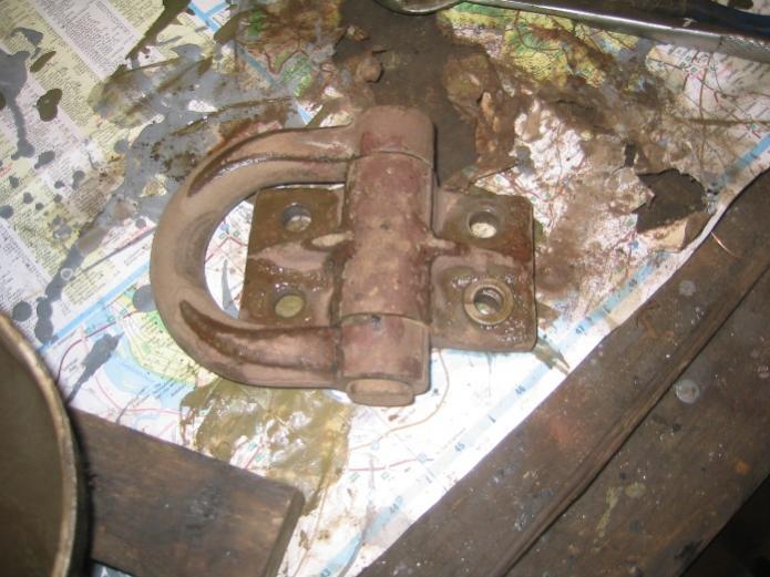

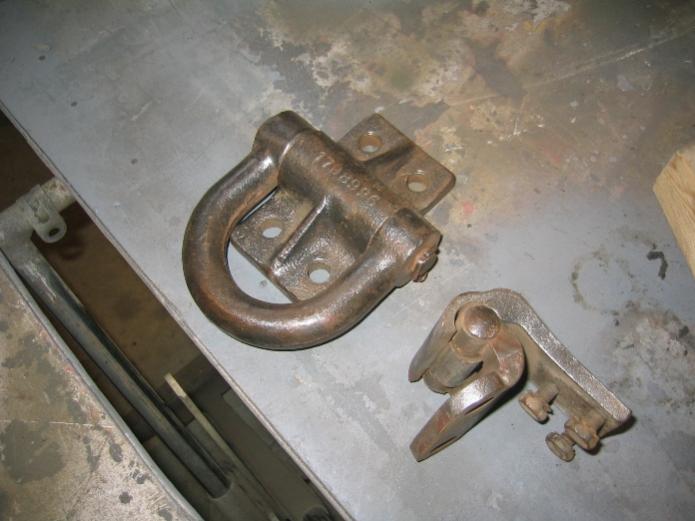

  #100
Old 08-04-12, 01:41
Default April Progress - Tip on paint removal
Hi All
What do these two products have in common?
They both remove paint and strangely the one on the right seems to actually work better, is cheaper, environmentally more friendly. Washing soda has come up over the years many times on MLU for various reasons such as Restoration Tip: Electrolysis Derusting, degreaser etc.
Well it was in the process of using it as a degreaser that its paint removing characteristics came out. Like with any degreaser they work better if the the part, grease and liquid are hot. So one day I throw bunch of grease small parts into an old electric fry pan with 1/2 cup of washing soda and gallon of water and left the whole thing to simmer for awhile while I did something else. The parts had a thick layer of grease on top of many layers of paint. When I pulled a part out of the simmering stew and when at it with a small wire brush not only did the grease come off but the paint as well.
The pictures below show parts simmering, what they look like as removed and after a few minutes with a wire brush.
Then spraying the parts with a good water based degreaser and washing the parts with hot water leaves them ready to paint.
Tomorrow I'm going to try hitting them with hot water pressure spray see if that will clean small parts which are hard to wire brush.
If that works got to find a bigger boiling tank.
As to the Aircraft Coating Remover, found that this tends to only remove one layer of paint at a time.
Comments and suggestions please.
April 7 HUP photos 001.jpg   April 7 HUP photos 002.jpg   April 7 HUP photos 003.jpg

I'm now to the point in the reassembly of the HUP that the wiring harness, fuel lines, break lines have been all installed. One small weeper leak in the brake system of course it is the big fitting on the master cylinder which should seal OK just needs to be tightened but of course will mean bleeding the entire brake system again.
In painting small parts to reinstall I came across one brass marker light I'd heard that these existed but this is the first one that I actually seen.
