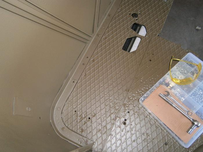

Name:	floor bolts painted.jpg
While I was there, I took the time to paint as many bolts as I could. Three coats each takes a lot of time!!!
